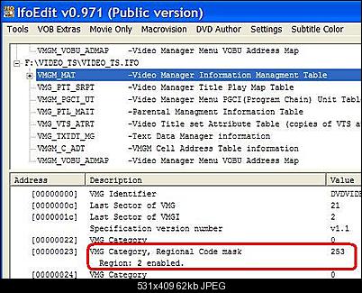

    For amusement I used IfoEdit to change the region code on a burned DVD to region 2.
    My region 1 players rejected it and my region 0 player accepted it - as I expected.
    I was surprised that WMP played it ok on the PC as my burner is a regular RPC-2 unit.
    I don't have a commercial region 2 disk to compare, but wonder if there is another location on it that would be honoured by the burner.

    Open the DVD using IfoEdit.
    Select 'VIDEO_TS.IFO
    Click on VMGM_MAT
    Note the Region coding and insert the value required.
    253 is Region 2
    254 is Region 1
    0 is All regions
