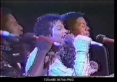

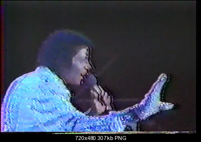

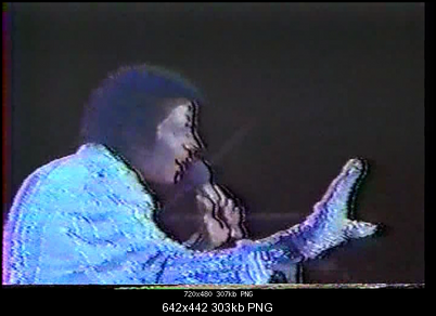

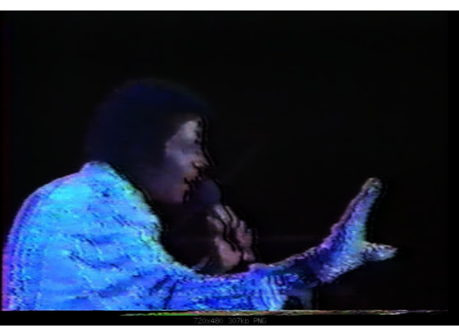

    Hi guys im trying to make a rare concert better but there seems to be 2 persons on the same video etc ill show you the pic so you can see what i mean. i tried my best with edge blurring etc and got rid of most but you guys here might have the solution.Click image for larger version
ID:	1826Click image for larger version
  2. With all those macroblock artifacts it's pretty hopeless. Even without them any halo removal will leave you with a blurry image.
    Jan 2007
    Republic of Texas
    From the top image, it is easy to tell that your source was a VHS copy of a VHS copy of a VHS copy. This was the major shortcoming of analog -- it did not duplicate well. That halo effect is very typical of multi-generational dubbing, and as jagabo has pointed out, there is little that can be done at this point. You either live with the halo effect or blur the image to a blob.
  4. you can manually work on each frame (e.g. in photoshop or after effects) with use of rotoscoping and masks to aid; at least you limit the "damage" to the reducing the halos or sections of the frame instead of blurring the whole image

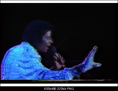

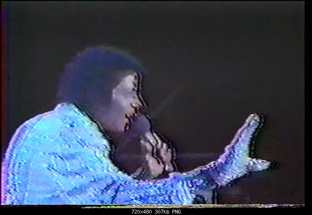

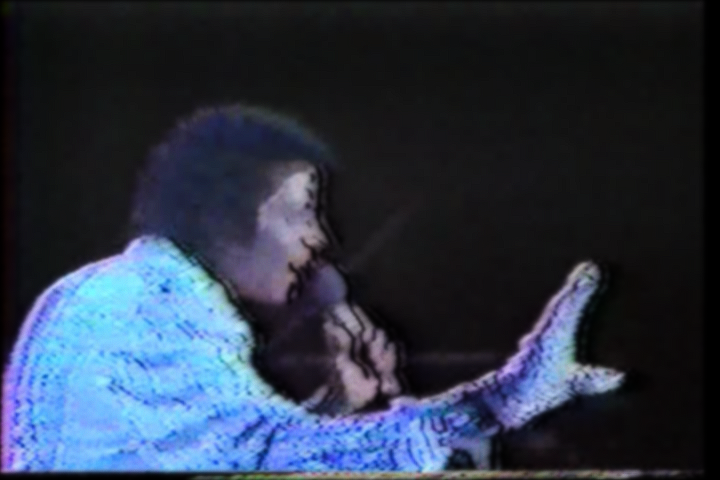

    ok i got rid of most of it, now how do i auto detect edges so i can add blur? either in photoshop, avisynth or other programs i dont mind, i know there must be a way to auto detect the edges, i dont mind if its not 100% accurate, but this will save me manually editing, heres the new improved b4 and after.
ID:	1897Click image for larger version
    Oct 2008
    anyone? i have searched google how to find edge automatic and then blur but got no real info, and someone here said its possible but not accurate, i have tried magic wand tool in photoshop but when i apply a script it doesnt always select where i want to, so is there any plugins or programs that finds the edges and selects so i can apply Gaussian blur? or any avisynth script?

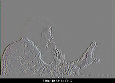

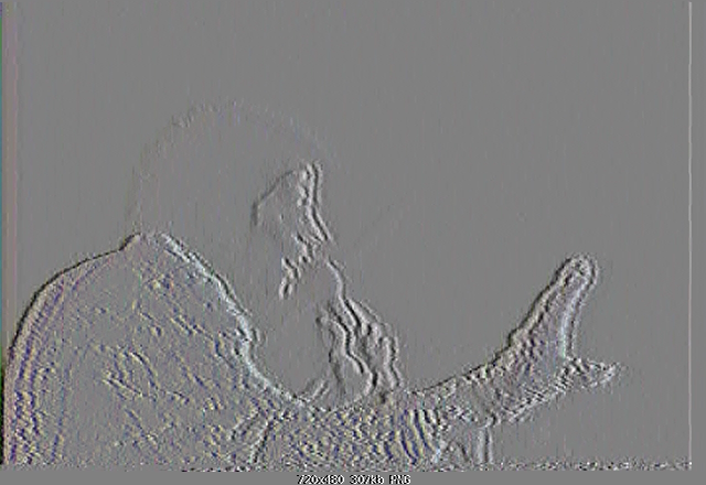

  12. Try an emboss filter. You can create an emboss filter in AviSynth by subtracting the frame from a copy of itself shifted left or right.
    src=ImageSource("0000.png", start=0, end=23, fps=23.976).Crop(0,0,-2,-2)
    emboss=subtract(src,crop(src,2,0,-0,-0).AddBorders(0,0,2,0)).ConvertToYV12()
    That will give you a grayscale image where flat areas are medium gray (128) and edges are either darker or lighter:

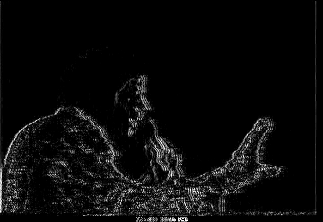

    So you'll have to follow up with an absolute value, abs(y-128). In the absence of abs() you could Merge() two ColorYUV() filters in AviSynth:
    v1=ColorYUV(emboss, off_y=-128)
    v2=Invert(emboss).ColorYUV(off_y=-128)

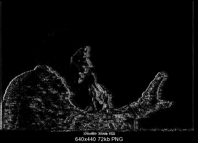

    Merge(v1,v2).ColorYUV(gain_y=1000)
    Then you'll probably want to blur that and use it as a mask. You can adjust the threshold of the mask by subtracting from it (ColorYUV(off_y=-32), for example) and/or adjust the strength by increasing the gain (ColorYUV(gain_y=1000) shown).
    In the end, this probably won't help you much because the DeHalo() filter does something very similar internally.

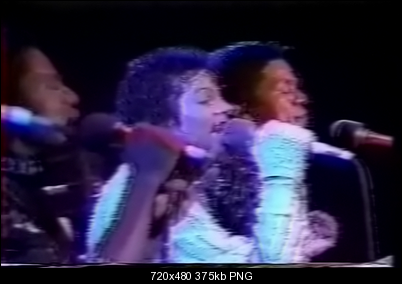

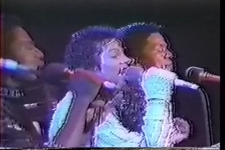

    anyway just to update i used your blindehalo3 settings and tweaked it and added see saw and changed levels etc, added grain and its looking quite good thanks to you, heres a comaprison. any suggestions in improving even more or what sharpen is better for this situation, i like see saw but maybe limited sharpen faster? i need something that brings out as much detail as possible.
ID:	1921Click image for larger version
