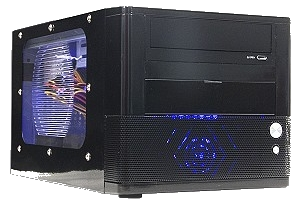

    I was wondering if anyone had any thoughts on building a low power desktop that had similar power specs to a laptop. Laptops tend to be very low wattage and are good on electricity and I wondered, "How low can I get a Desktop in terms of power?"
    I may be moving shortly and have decided not to take my massive quad core machine(too bulky to carry in my little truck and I may have it shipped later on) and thought a laptop would keep me going for a while. When I get to where I'm going I thought I might need to keep bills low at the start but thought it's gonna be hard for me not to have a desktop around so why not try and build a low wattage/power desktop. The PC I'm on now has been running for the last 4 years and with my Voltage/Wattage meter it says it idles at 130 watts. I'm not sure what that means in terms of the cost it takes to run a month but maybe there's hardware out there that could do the job. This PC is just for surfing and downloading and nuthin more so the specs wouldn't have to be too high. This is a project I would like to try and keep quality at a reasonable level and costs low. I've even thought about those Mini ITX Computer Cases but am not sure about em cause I've not dealt with them.
    any thoughts/ideas/suggestions would be appreciated.

    http://www.newegg.com/Product/Product.aspx?Item=N82E16811112265
    http://www.newegg.com/Product/Product.aspx?Item=N82E16811112266
    Those are Lian Li's new models for mini itx cases. It has much better cooling compared to last years model that I used for a mini itx system. Dunno what your budget is. Use one of those atom based cpu mobo combo's. AMD doesn't have many mini itx cpu/mobo combo's. Intel seems to have more available.

    Cooler Master Elite 360 micro atx case, $39.99 free shipping amazon.com
    http://www.amazon.com/Cooler-Master-Elite-RC-360-KKN1-GP-Desktop/dp/B001TUYTZ2/ref=sr_...3724184&sr=1-6
    Cooler Master Elite 310 case, $39.99 free shipping amazon.com
    http://www.amazon.com/Cooler-Master-Window-RC-310-SWN1-GP-Silver/dp/B002XIST2I/ref=sr_...3724184&sr=1-8
    I just used the CM Elite 310 case for my AMD build.
    IMHO mini itx systems are a PITA. Not much room for cable management because the footprint is small. I built one last summer and sold it on my local craigslist for $360.00. Some mini itx systems the cpu cooler can be blocked because of the limited space. When I used a full atx power supply it hovered over the cpu cooler. Luckily I had a spare micro atx power supply to use. I've seen guys mod the mini itx cases to add more fans to it. That Lian Li link I provided is a ideal case because at least now it has a 120mm and 140mm fan. The Lian Li case I used had no fan holes.
    As redwuz mentioned just keep a look out for sales at Newegg or even at Fry's Electronics. Newegg has their usual Tuesday and Thursday email specials.

  27. Member Webster's Avatar
    [Attachment 1813 - Click to enlarge]
    thanx
    For what it worth, I’d just put together a mini system using these parts for an HTPC:
    AMD Athlon II X2 240 Regor 2.8GHz 2 x 1MB L2 Cache Socket AM3 65W Dual-Core Processor
    http://www.newegg.com/Product/Product.aspx?Item=N82E16819103688
    ZOTAC GF6100-E-E AM3/AM2+/AM2 NVIDIA nForce 430 MCP Mini ITX AMD Motherboard
    http://www.newegg.com/Product/Product.aspx?Item=N82E16813500045
    SILVERSTONE Sugo SG05-B Black SECC / Plastic Mini-ITX Desktop Computer Case SFX 300W 80Plus Power Supply ***good mini case with plenty clearance for CPU cooler if you want to use stock cooler. Most other ITX cases will not have enough clearance between the CPU cooler and the power supply. If you get those cases, you will end up spending about another $20.00 or more for a low profile cooler.
    http://www.newegg.com/Product/Product.aspx?Item=N82E16811163149&cm_re=silverstone_case...-149-_-Product
    Western Digital Caviar Green WD5000AADS 500GB 32MB Cache SATA 3.0Gb/s 3.5" Hard Drive -Bare Drive
    http://www.newegg.com/Product/Product.aspx?Item=N82E16822136358
    some leftover RAM from my drawer:
    CORSAIR XMS2 4GB (2 x 2GB) 240-Pin DDR2 SDRAM DDR2 800 (PC2 6400) Dual Channel Kit Desktop Memory Model TWIN2X4096-6400C5
    http://www.newegg.com/Product/Product.aspx?Item=N82E16820145184
    Using KillaWatt to measure power usage. Total power usage at full drive spinning, 100% CPU load at stock speed is at 84-90 watt total. System at idle is at 63-65 watts total. I can lower the total watts usage by lower the core CPU voltage to 1.1V then the system idle at 60 watts.
    I could have lower the power futher if I was using single core AMD Sempron 140 Sargas 2.7GHz 1MB L2 Cache Socket AM3 45W Single-Core Processor
    http://www.newegg.com/Product/Product.aspx?Item=N82E16819103698
    I’ll get this chip soon to check and see how much less power will this system need. I wanted to eventually run the computer fulltime using a power inverter with 4 x 12volts battery bank which is charges by solar panel.
