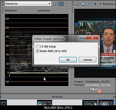

    OK I misunderstood. The DSR-11 should have a 7.5 IRE switch is this correct? If switched to 7.5 IRE, then a standard 16-235 DV tape should play correctly to analog 7.5-100 IRE.

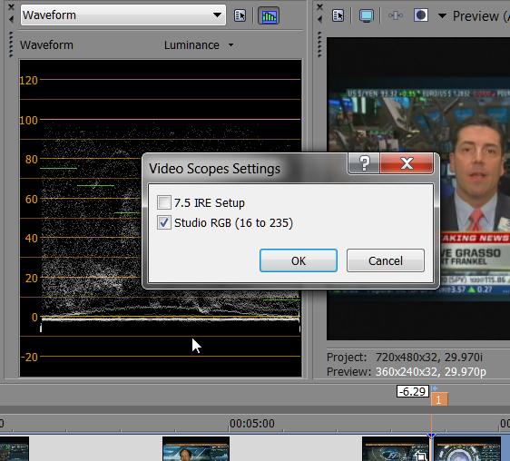

    You should use standard DV project templates and "Studio RGB (16-235)" for the waveform monitor. 7.5 IRE should be unchecked for DV, HDV, AVCHD DVD, etc. This setting is for studios that run digital 7.5 setup. That is rarely done these days. Most studios use 16-235 digital levels.

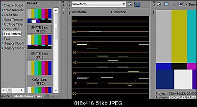

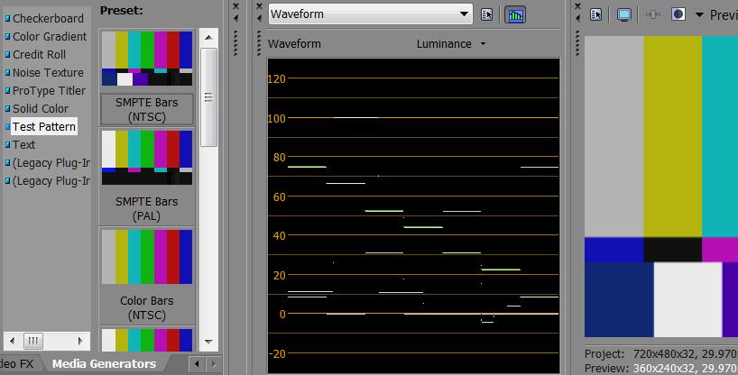

    Your SMPTE Bars (NTSC) test pattern should look like this on the digital timeline.
    100 = digital 235
    0= digital 16

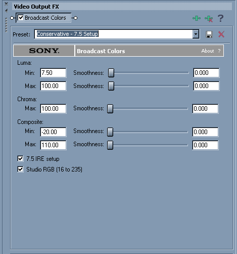

  6. My Sony DSR-11 do not have a 7.5 IRE switch. This 7.5 IRE switch is typical by JVC or Panasonic models. What about my Video output FX ? Do i have right setup ? Please see my picture bellow. Thanks
    That filter is intended to correct a 32-235 level shifted input. I need to research the modes and will post back later.

  9. I dont have Canopus ADVC100, I have home a ADS PYRO A/V link do you think is good too? If not ten I do not want to buy any new hardware. Did you saw my picture above ? Do you think this setup in Video Output FX will be helpfull?
