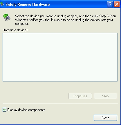

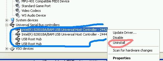

  1. I clicked on an exe that deals with low level formating of a USB flash drive. I did not actually start formatting the flash drive. I then deleted the exe (green software). However, now when I plug in any USB flash drive, the green notification doesn't appear (a different icon -see white circle at bottom of screenshot 1) appears for a few seconds and then goes away) and so there is no normal way to stop the USB flash drive before pulling it out. (clicking Eject doesn't work for all USBs that I tried). I searched around for solutions. It has nothing to do with "show hidden notifications". Even the dialogue box that is supposed to show attached USBs is empty (see screenshot). One possible solution I found is to delete USB drivers (see screenshot 2).
    You can see there are 4 of them.
    My question is: if I delete these drivers (which of the 4 should I delete?), and then restart Windows, will the drivers automatically re-install? I don't want to delete drivers if they won't come back automatically.
    Also, in My Computer, I can access and use the USB flash as normal, I just can 't get the green notification to appear, which makes it hard to "stop" the device.

    yes you can delete any devices and then on reboot windows will find it and re-install the driver.
    may as well uninstall them all.
  3. I deleted all 4 of the USB drivers, rebooted, the 4 drivers came back, but unfortunately, I still have the same problem (no green USB notification when USB is plugged in and consequently, no method for "Safe to remove".

  10. Thanks for the two "workarounds" which do work.
    Both workarounds will stop the USB and then the USB drive is no longer visible in "My "Computer".
    The second workaround also allows me to delete the USB software installation. Re-inserting the USB will then re-install the USB. No problems.
    To try to solve the "no green USB notification", I again deleted all the USB drives ( see above screenshot)
    disconnected all USB devices from the computer, rebooted, but that did not solve the problem.
    Also, the "Safely remove hardware" dialogue box (see screenshot) is always empty ( one way to get this dialogue box to appear is type exactly Start>Run>RunDll32.exe shell32.dll,Control_RunDLL hotplug.dll )
    , even when there are active USBs inserted in the computer.
    So to sum up, there are 2 strange things going on that I guess I can live with:
    1) "Safely remove hardware" box is always empty, even when active USBs are connected
    2) Never get green USB notification when active USB is connected

    Looks like you lost a registry key or keys. (Win7 has 2) Easy way is to make a .bat file and put it in your startup folder. Open notepad and put in what you wrote above -- "RunDll32.exe shell32.dll,Control_RunDLL hotplug.dll" save as anyname.bat
    That should work. To do it right do this --- If you have access to a XP box, just search for "hotplug.dll" export all keys found as .reg and copy then run in your box.
