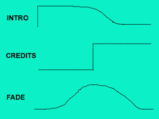

    You wouldn't have to join anything if you made two bitmap images (an intro and a small credit) and used the overlay filter in blend mode with the curve editor.
    Make one instance of the overlay filter with the intro bitmap and use the curve editor to end it where you want. By using a curve instead of just a straight vertical line, you'll get a fade at the end of the intro.
    Use Smart Render and save a new file.
    Open the new file and make another instance of the overlay filter using the credit bitmap. This time use a straight vertical line to where you want the credit to start.
    Use Smart Render and save the new file.
    Open the new file and use the Fill filter in blend mode with the curve editor to make a fade between the end of your movie and the start of the credit.
    Use Smart Render and save the finished file file.
    An option for joining the files that you already have in Virtualdub is to change the framerate of one to match the other. If one is 29.9700 then change the other to 29.970000000000. With all the zeros on the end, it should guarantee that both files have the same framerate.
    If you want rolling credits at the end, you could use Windows Movie Maker to create the rolling credit and then convert to AVI using the same codec as your movie and using the framerate trick above to make it match your movie so that it will join in Virtualdub.
    Curves...
    Image Attached Images

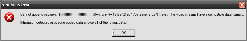

    tried that. have got two silent video files now. Still getting this error when trying to append:
