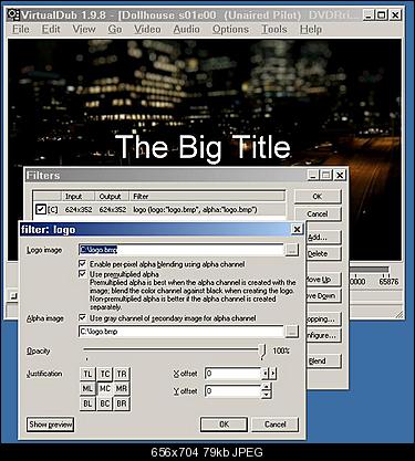

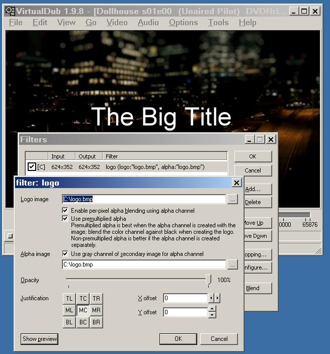

    The problem you'll have is positioning them. By default they will go at the bottom of the video. You should probably use the logo filter instead. A cheap trick is to use white text on a black background, then use the same image as the logo and the alpha channel.

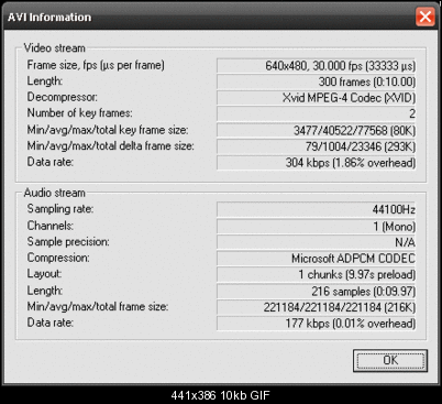

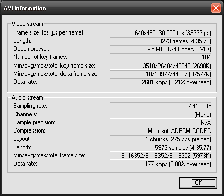

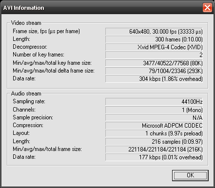

  27. ok, I'm almost there!! I now have a main large file and a smaller "credit" file that I want to append onto the end. VirtualDub won't let me though and keeps coming up with an error:
    "The video streams have incompatible data formats (mismatch detected in opaque codec data at byte 21 of the format data)"
    except, I've made sure the files are the same (as far as I'm aware)!! Attached is the "file information" for both files...
    Any ideas? I'm so close.....
ID:	1837Click image for larger version
  28. VirtualDub can be picky about what files it will append. In cases like this it's usually best to resort to AviDemux to append the two (or more) videos.
