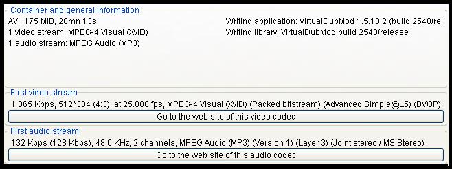

    I have pal television programes that annoy me (media info above).
    I can't live with the 4% increase in speed and pitch any longer
    I have scrambled online and only seem to find solutions for mac owners. its really bugging me.
    There's a number of methods of converting PAL to NTSC. The ''Slow PAL'' method seems to be the best one as it will slow the audio pitch and speed BACK to human levels.
    Does anyone know of what software is BEST for this conversion? for a PC? NOT a mac?
    thanks alot for reading and i hope someone can help.
    cheers,
    dave
