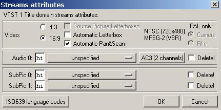

  3. You made these yourself? If the video is set as Wide/Pan And Scan rather than Wide/Letterbox, on a 4:3 TV set the video will be shown with the sides cropped off, or fullscreen as you phrased it. The fix is to change the video attributes to Wide/Letterbox. PGCEdit is the way I'd do it, but IFOEdit can do it also. If that's the problem.

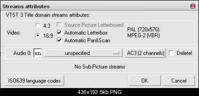

  5. You don't need a guide as it's too easy to do, although I expect the good included help file will explain it for you. Open the DVD in PGCEdit, right-click on the video in question, and hit 'Domain Stream Attributes'. If it says 16:9 and Automatic Pan&Scan, change it to 16:9 and Automatic Letterbox. If that's the problem.

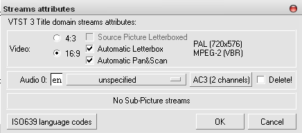

    well the IfoAR2WS didn't work for it so I opened it up in pgcedit and oddly enough, both of those boxes were already ticked
    so now i uncheck the pan and scan checkbox?
    @#$%* update...The PGCedit tip worked!!!!!thanx for your help manono

  7. You're welcome. You may also have your DVD player set up to output Pan And Scan. If so, change it also.
  8. Originally Posted by Moontrash View Post
    [Attachment 1766 - Click to enlarge]
    When both P&S and LB flags are set, your DVD player is supposed to select the rendering mode according to your preferences. So, I suspect a problem in the setup of your standalone player. Try to set it up again.
    Selecting only one video mode in PgcEdit forces the player to use that mode anyway, regardless of the configuration of the player. Usually it's what you want for the movies, as normally only some DVD menus are authored with both flags set, and they are carefully designed for that purpose.

    I looked in my video settings in my dvd player and you were correct r0lZ, it was set to 4:3 pan and scan. I changed it to 4:3 letterbox and it was widescreen. Thanx for that.
