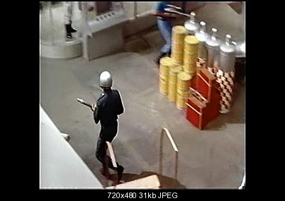

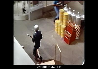

    Alright, here's an example. In the second image, we have the original frame. It had two-pixel black borders on the top and bottom before, but I shifted the frame down one pixel in an attempt to compensate for the fact that CCE's encodes were shifted one pixel up. This did work, but CCE tricked me by duplicating the second-from-the-bottom scanline at the bottom, resulting in the solitary scanline phenomenon you see at the bottom of the first image. Needless to say: Unusable. And I again point out that this was happening with both SP1 and SP2.
