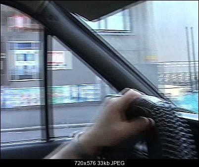

  5. Mod Neophyte redwudz's Avatar
    USA
    Interlace distortion looks something like this, though this is a extreme example:
    If the edges are smooth and you just have ghosting, then that's something else. Are the 'ghosts' the same color as the images? If not, maybe a color channel is offset. But I'm just guessing. Even a screen shot would help...

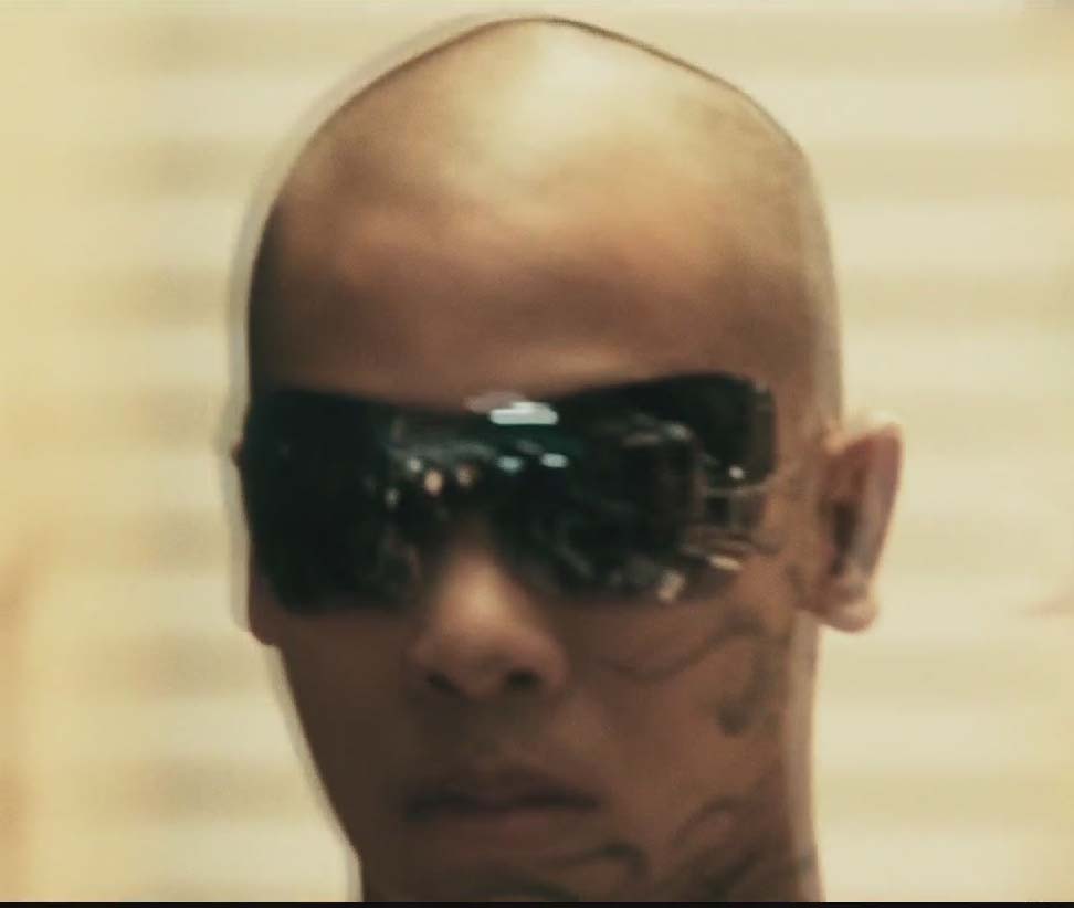

    Feb 2010
    thailand
    The attached picture is the said issue which edge of picture is distortion as explanation's redwudz. The source of video is B13-U (MOVIES),
    details of video as the following. H.264 , 1920X1080p , 23.976 fps and Profile : High @4.1 ...
  7. Member edDV's Avatar
    Mar 2004
    Northern California, USA
    So it isn't a camcorder file.
    Whoever created this conversion to 23.976 progressive did a faulty inverse telecine or it wasn't "24p" source to start.
    No it can't be fixed.
