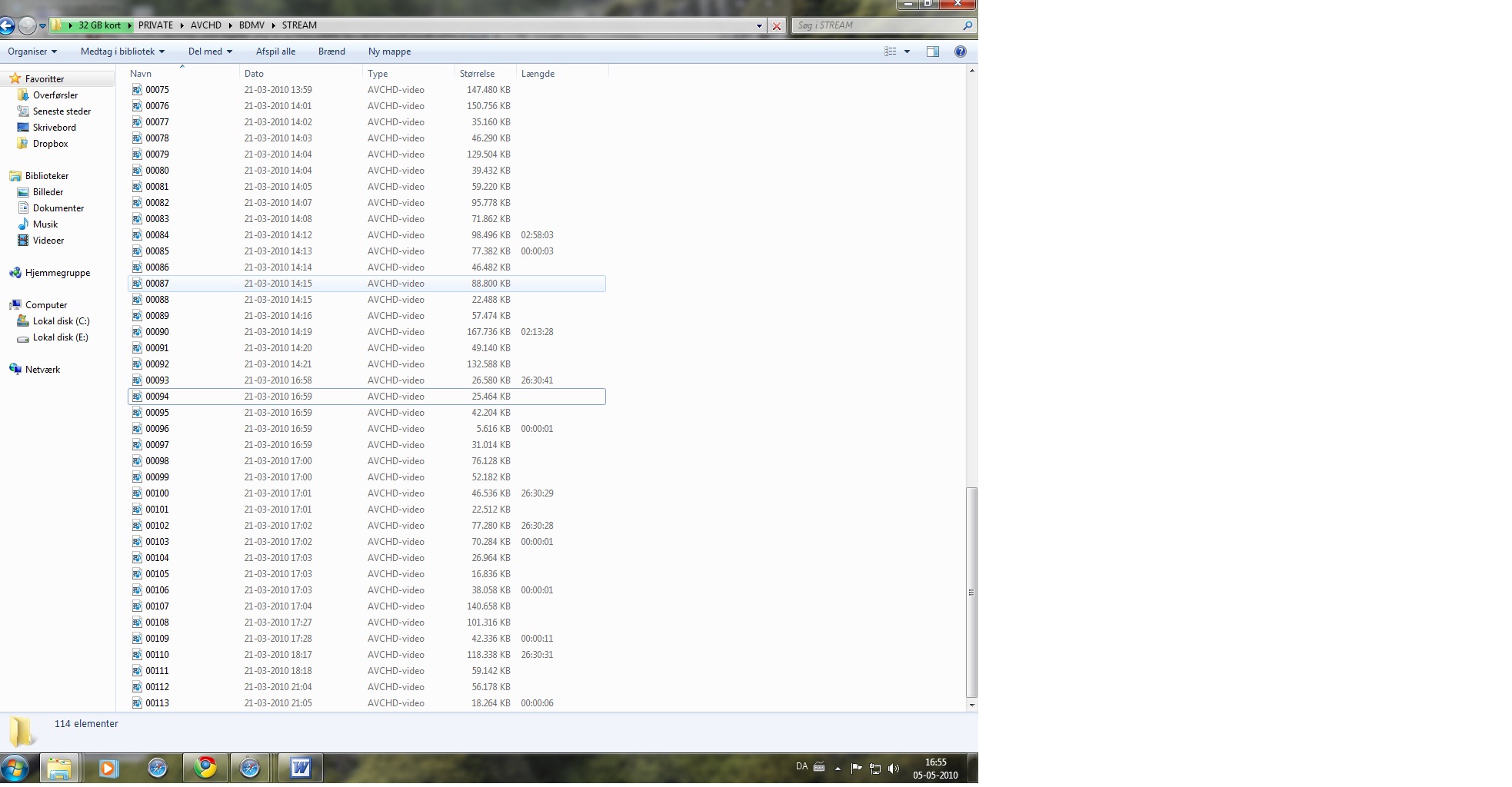

    I have problems playing recorded MTS files. I bought a 32 gb sdhc card for not so long ago on the web. It was a cheap SDHC card from China. Of the 113 recorded files the first 30 shots worked fine, but the remaining files are defective.
    No matter what clip I choose to play of the defective files, the same clip of 9 seconds duration is being played each time. Looking at the clips we see that the size of the files is different, as seen in the attached picture.
    I hava a Canon HF200 camcorder
    Can any one help me with this problem?

  2. In all likelihood you can forget about them. Your card is almost certainly fake, and probably only has a capacity of 2GB or so. The files that don't work simply don't exist on the card; they're just records on the master file table that point to non-existent locations on the card. In this case I'm guessing they all point to the same cut-off video file at the end of the card.
    My conjecture is based on my own experience with a cheap 16GB SDHC from China via eBay. Everything past 1.8GB was just garbage data. My brother lost a whole load of overseas trip photos that way. Plus I never managed to get a refund since I only realized this months after I bought the card.
    Thanks for a quick response. I was afraid that was the problem
