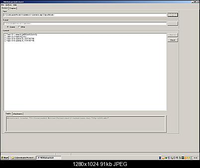

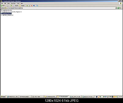

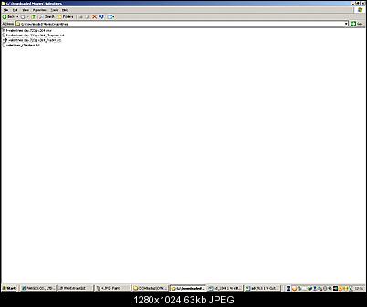

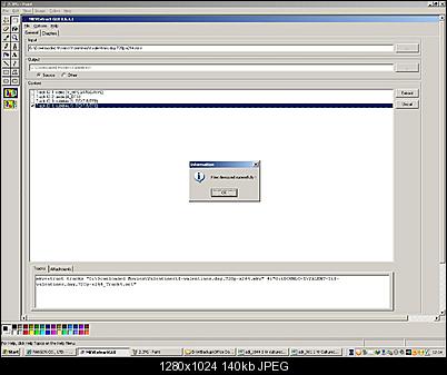

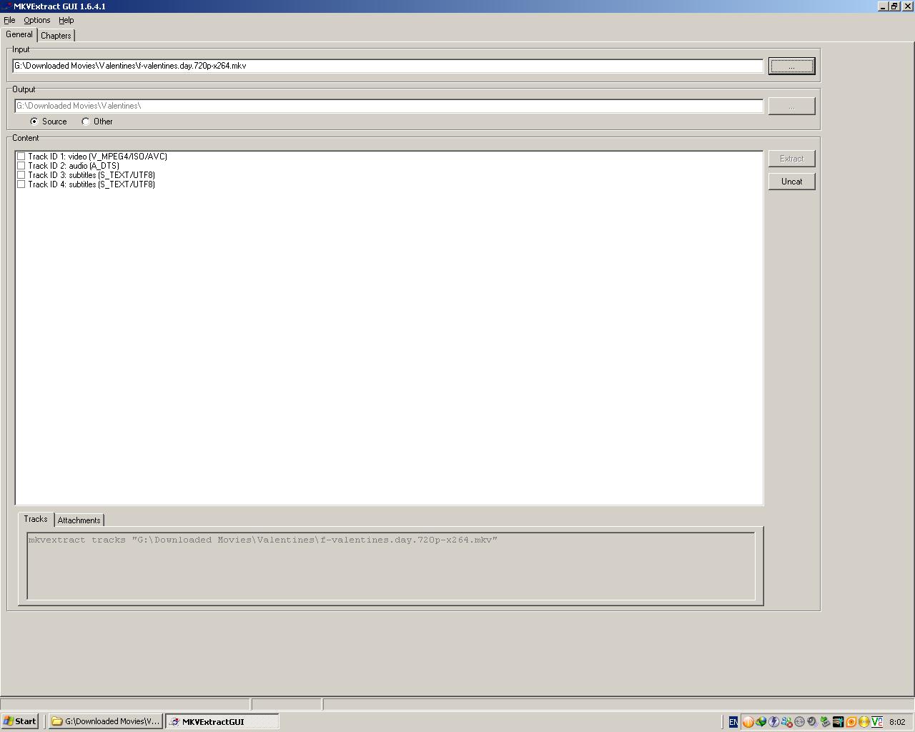

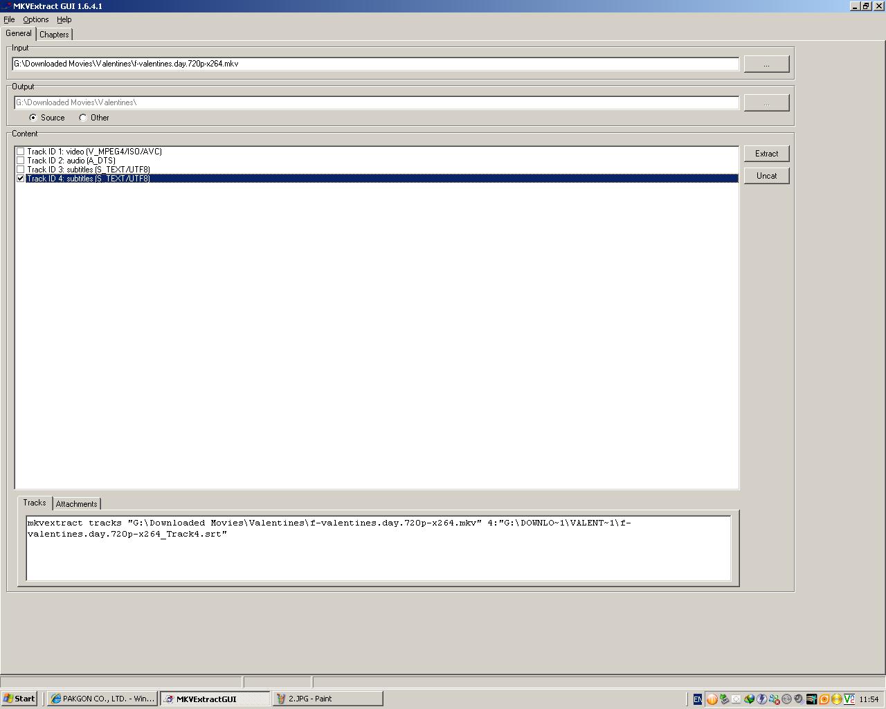

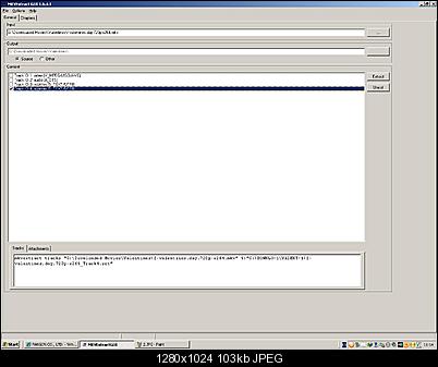

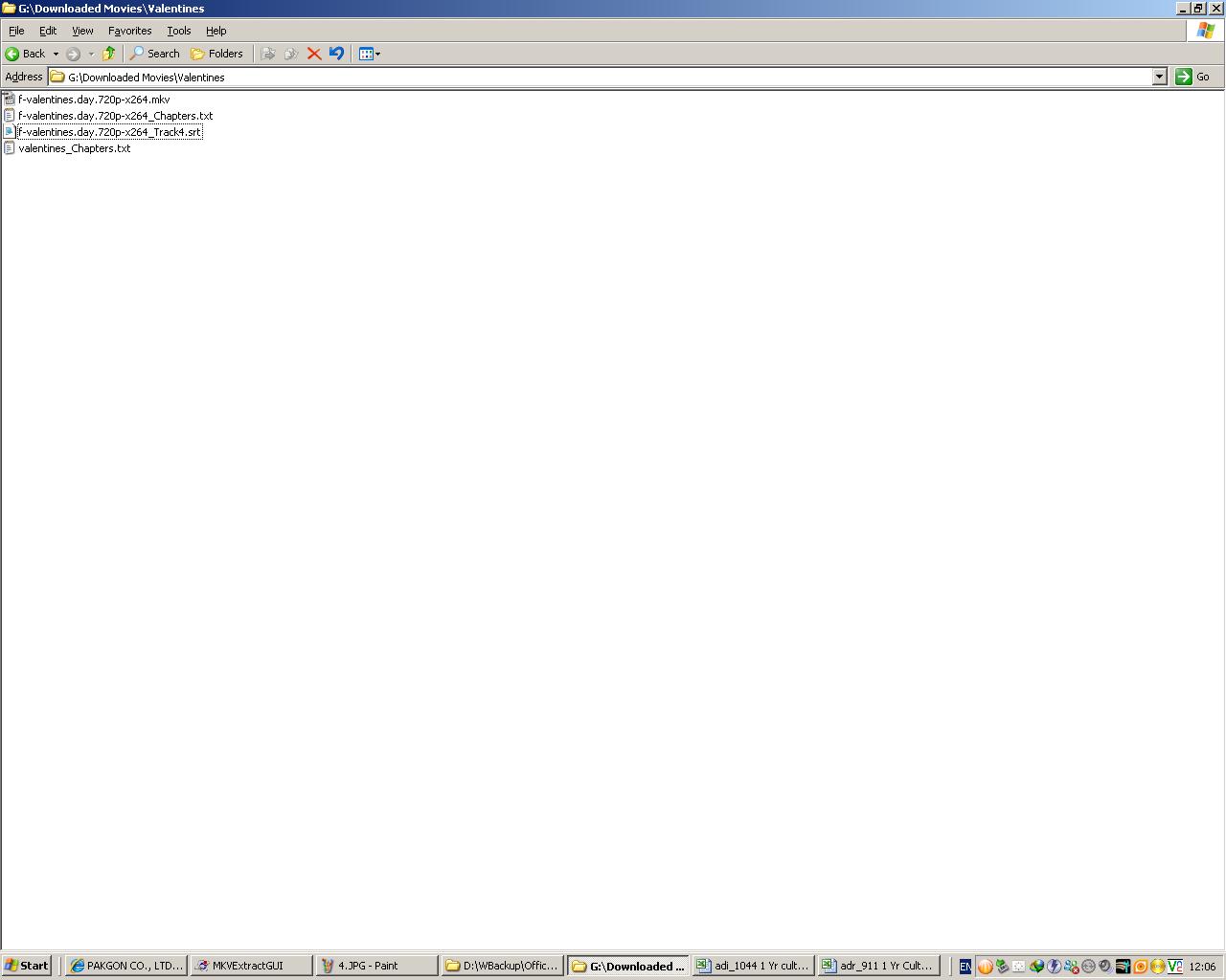

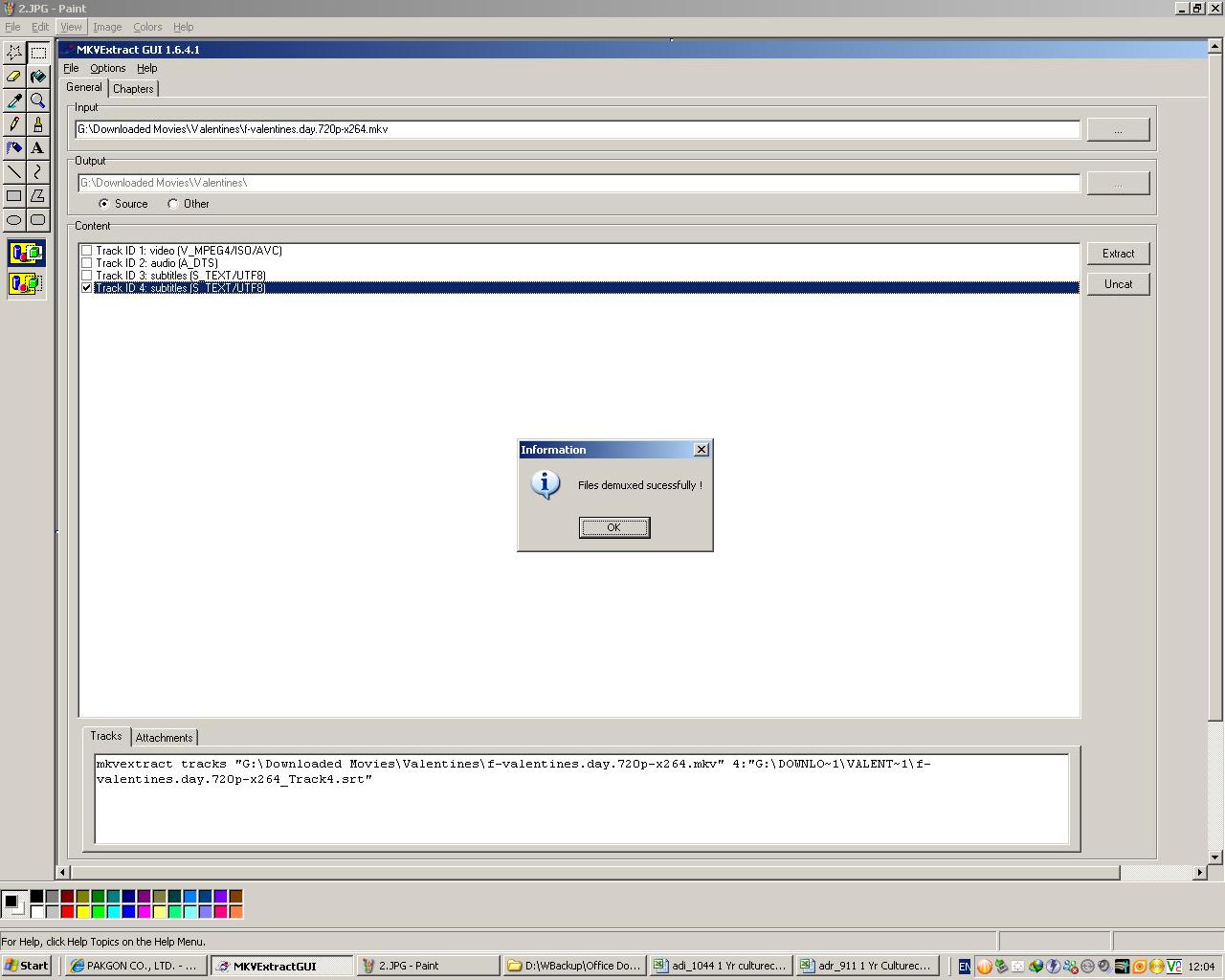

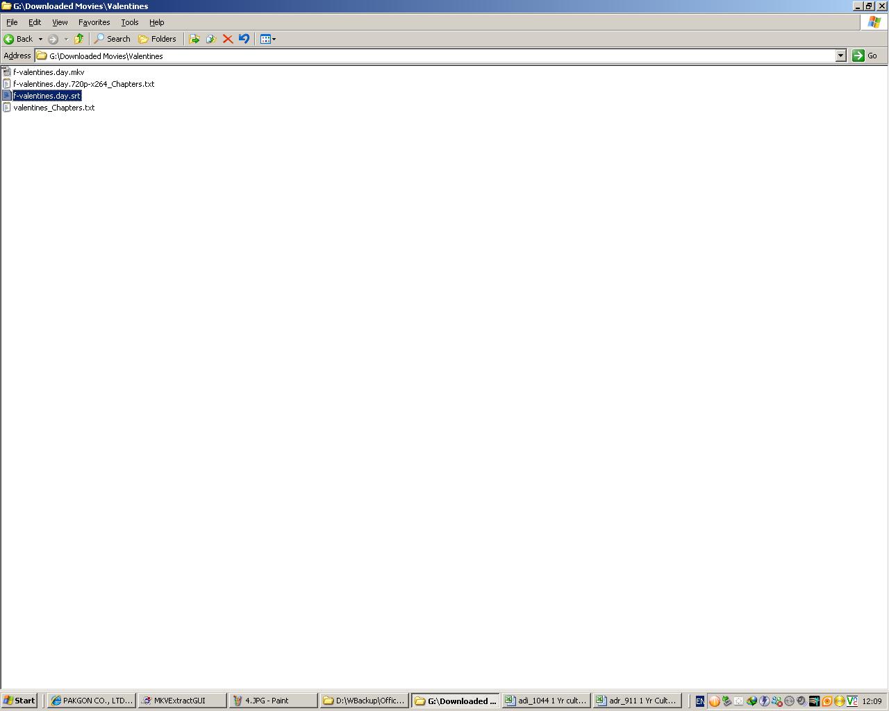

    I still have problem to playback .mkv move. I've changed the name of .SRT to be the same name as .mkv but I still don't see the subtitle. Again, I'm using LG BD350 Bluray Disc Player with USB hard drive. Here's what I've done to rip the subtitle;

    After I extracted the file, I changed the name of .srt to be the same name as .mkv file. When I playbacked the movie, the subtitle still doesn't show up on screen. It happens to every .mkv movie accepts any .mkv movie which I playback with the downloded .srt sub. So, I think I might have done something wrong when I extract the subtitle. Do you have any idea to suggest so I can fix the problem?
    Thanks.
