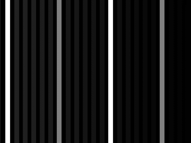

    You should see veritical lines like these scrolling to the left smoothly:
