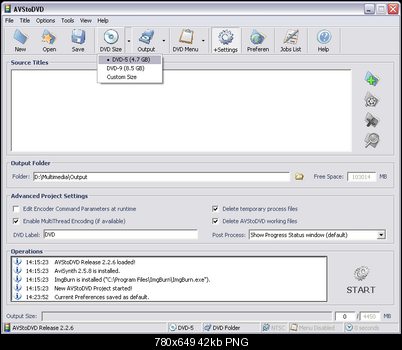

    Click on the DVD Size
  3. Thank you for the fast response Baldric,
    I tried that option first, with 3 .avi files to make up one DVD and the results were over 5gb when saving to folder to burn later.
    I figure maybe I am missing something. I had set the conversion to use HCenc 1 pass.
    Should I be looking at a setting elsewhere that I may have missed, or is it possible it just could not re-encode the files that low?
    To get the project to fit I ran the video_ts folder through DVD Shrink, and the results were fine for this pupose, but I'd like to avoid that extra step.
