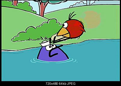

    I bought a bunch of DVDs that I'm trying to convert so that I can save them on my Windows Home Server. I was taping them off the air, but they were too compressed to start with and had a lot of MPEG artifacts, so I figured I'd buy the DVDs and start with a crisp source.
    Unfortunately, it seems even *after* I IVTC the video, there are interlacing artifacts (see the first image above - yes, this is a "solid" frame). Can someone explain to me how this happens and what's the best way to convert this to something I can just store and watch over a popcorn hour box?

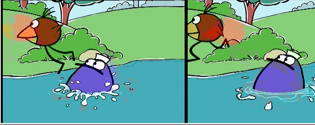

    This second frame I'm attaching is using VirtualDub deinterlace with two fields of a single frame unwrapped side-by-side. As you can see, it looks almost like a "temporal" image is shadowed onto EACH FIELD. Like the top field has artifacts of the bottom field in it, and the bottom field has artifacts of the top image in it. Is this normal? I take it there's no way to un-do this, so what would you do?
    Thanks for any suggestions.

    What did you use to IVTC ?
    You're probably seeing frame blending artifacts.

  5. VirtualDub does not handle interlaced YV12 correctly.
    https://forum.videohelp.com/threads/316415-Check-Over-My-Options-From-DVD-to-XviD-Conve...=1#post1958565
    https://forum.videohelp.com/threads/307116-8mm-film-and-the-msu-old-color-restoration-f...=1#post1890833
    If you really want to use VirtualDub's IVTC filters you can open your file with VirtualDub and use ConvertToYUY2(interlace=true) or ConvertToRGB(interlaced=true). But if you're going to do that you might as well IVTC in AviSynth. Try TFM() followed by TDecimate().
