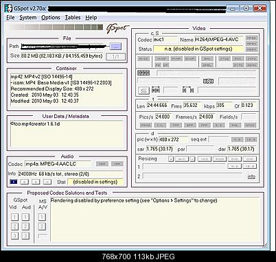

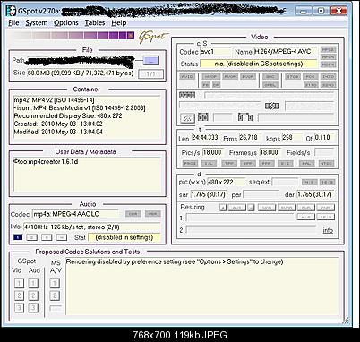

Here are the pics:

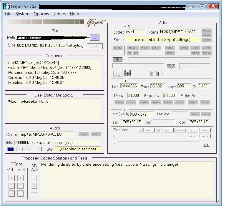

working flv to mp4 encoded file using the psp setting on format factory:

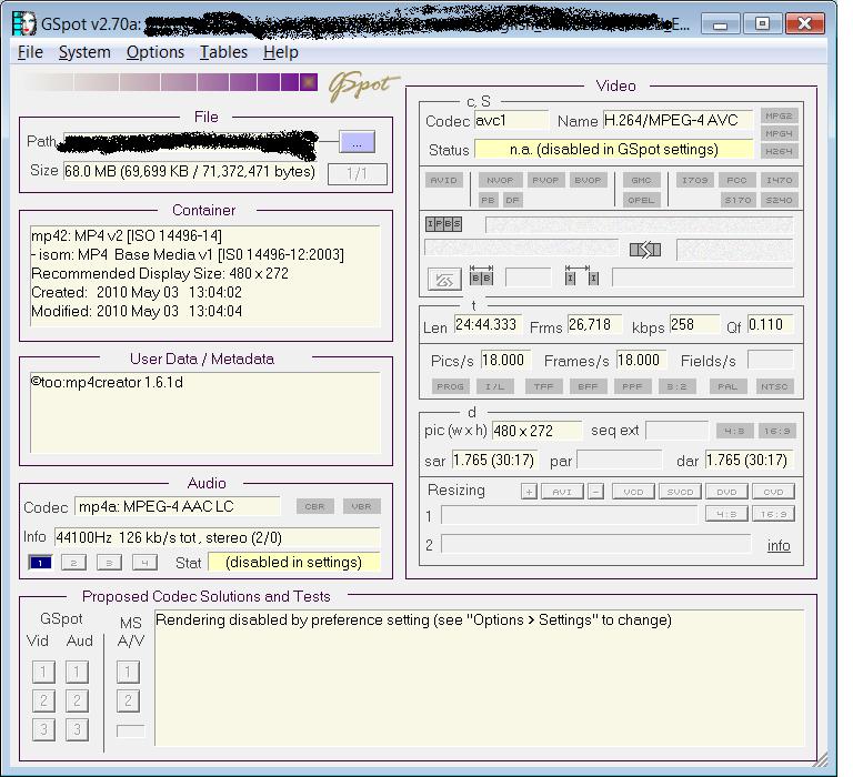

non working flv to mp4 encoded file using generic mp4 for mobile setting in format factory:
EDIT - Upon further review it appears that there is one other difference I did not see. The top screen shot of gspot shows 24fps for the working file while the ones that don't work have a 18fps for some frickin reason. Oh well it looks like I will have to go back to the flvs and start over.
I don't see any benefit from converting the mp4s o mp4 with a different fps. I'm sure in the end the processing time required and the inevitable quality hit with the conversion will not make it worth while. I had wanted to avoid starting over but it looks like now I have no choice.
