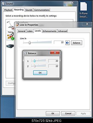

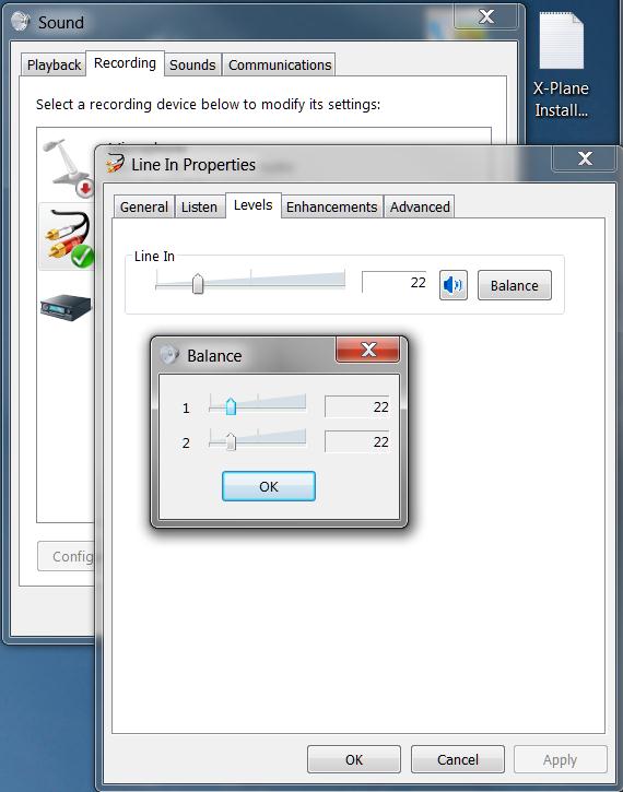

    In Vista and Win7, balance is located in the "Recording Device" panel. Some devices have more than two channels.

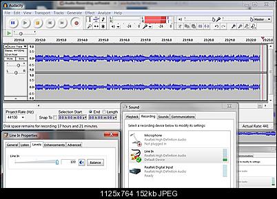

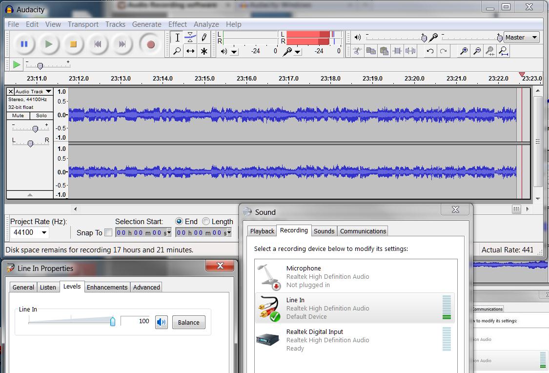

    Generally you set the device gain to 100. When you press the record button, stereo track gain and balance controls appear at the left as shown here. Master record gain is at the top.
    Yes, but the balance controls for input are part of the Windows audio control panels as mentioned above, not Audacity itself. Audacity itself can only set master gain.

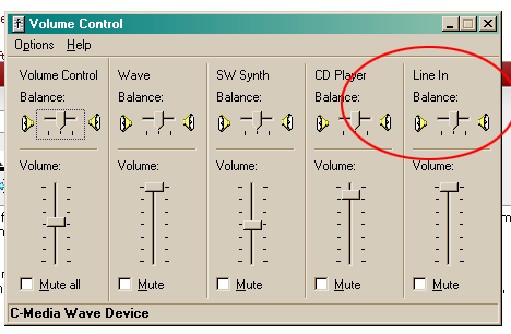

    OS?
    XP usually has a record level panel like the one AlanHK showed above. You would adjust the circled control "Line In Balance".
    Vista and Win7 have the Sound Device Line-In controls I showed above.
