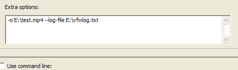

  14. That's not a log file. For the vfw version , you need to use the command line box to stipulate a log file
    This will explain what they mean
    http://mewiki.project357.com/wiki/X264_Stats_Output
    x264 [info]: ref P L0 46.2% 18.9% 13.6% 7.7% 6.9% 6.6%
    In this example, 46.2% used 1, 18.9% used 2, etc.... Similiarly for consec b-frames , but it starts with "0"
    x264 [info]: consecutive B-frames: 3.5% 10.8% 20.6% 28.2% 16.8% 4.5% 15.6%
    3.5% used 0 b-frames, 10.8% used 2 consec b-frames, etc.....
    If you use the extra options box, it will still retain the settings from the GUI,and just add additional parameters. If you use the command line box, it will use ONLY the box settings (i.e. override the GUI with your command line settings).
    In this example, I used .mp4 output for directory E , while saving the dummy avi to the desktop. The stats file was also saved to directory E. If you open the file with wordpad (instead of notepad), it will keep the formatting
