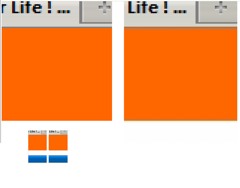

Hmm. I was tested play by using script YV12, It's little better but still too much pale. What I can do? - - For example I capture video on youtube* what color space of that video stream, I think it's not RGB but why I capture it a video is very pale when compare it. *(I know it can download)
You probably have a playback problem, not an encoding problem. Post a short sample of your source and your x264 output.
ConvertToYV12() - Use this script to play.
Player - MPC
Filter - AVI Decompressor (YV12)
left - desktop
right - video
You will see gray line at top and bottom on left which is original but video became orange.
This image is exactly as I see when play.
[Attachment 1667 - Click to enlarge] -
We can't see anything , the screenshot or file, or whatever you uploaded didn't work
http://img682.imageshack.us/img682/4930/37110095.png Gray line on top and border on bottom. Can I encode for clear orange area like left picture which original picture. Right picture is very rough*. *I don't know what it this for call.
What you are seeing is normal when converting RGB to YV12. YV12 encodes colors at half the resolution (both axis) so sharp colored edges or other small colored details get blurred. All MPEG family encoders work in YV12 internally (actually some MPEG 2 encoders have a YUY2 mode). More examples:
