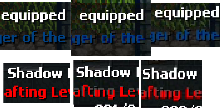

The dark blue text is effected the same way. It's just harder to see. Different renderers stretch the low res chroma channels differently so exactly what you see may vary. But here's are 4x nearest neighbor enlargements (so you can see each pixel easily) of the original (left) and two different renderers (center, right):
[Attachment 1654 - Click to enlarge] -
