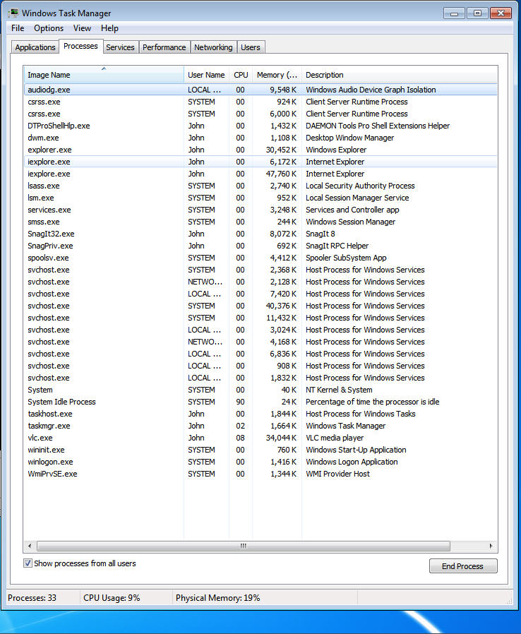

    Umm
    not sure
    all I know is for as long as I can remember I have had video problems

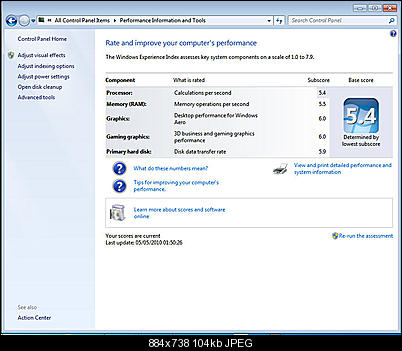

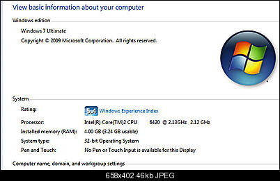

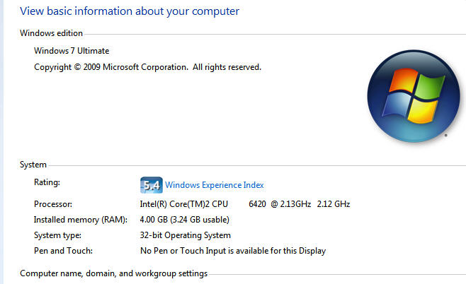

    when playing black.mpg my system idle is 67 / 54 % using VLC Player

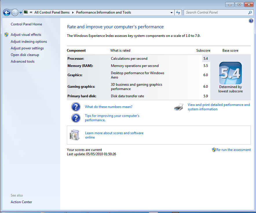

    here is the spec of this machine, though not the fastest processor !!
    thanks for you advice

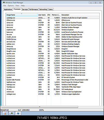

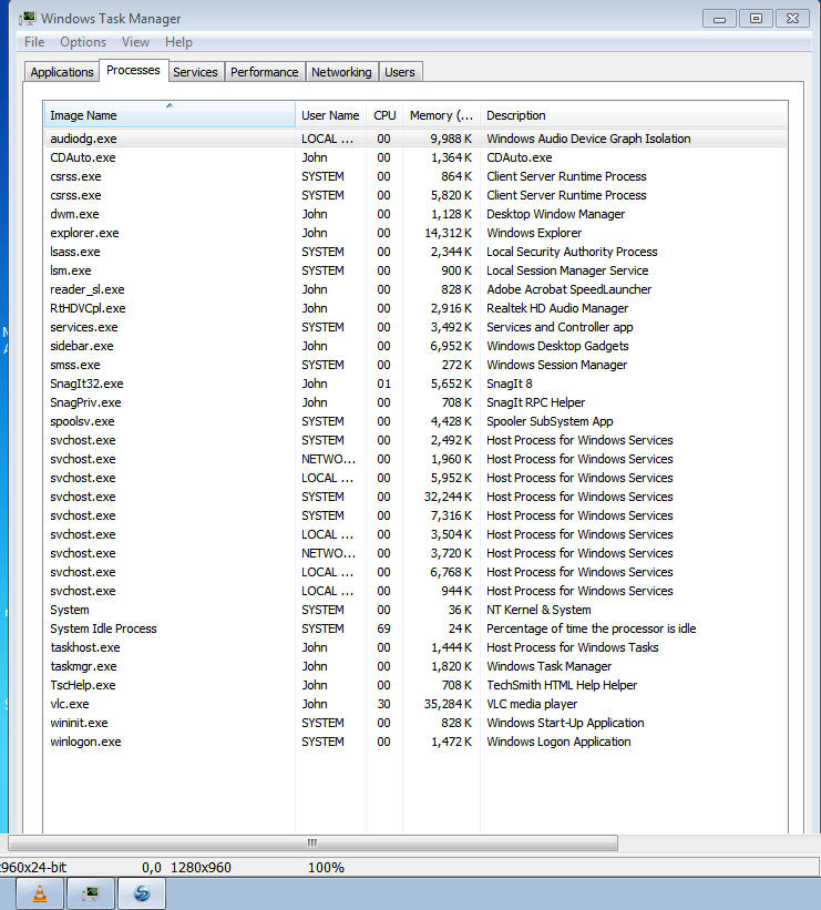

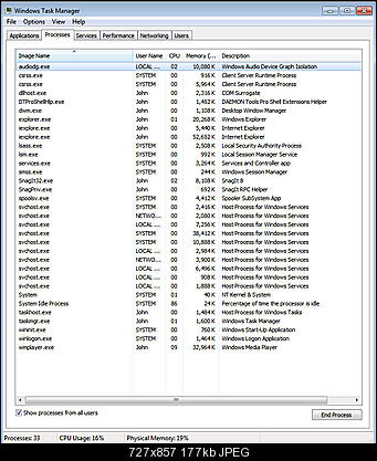

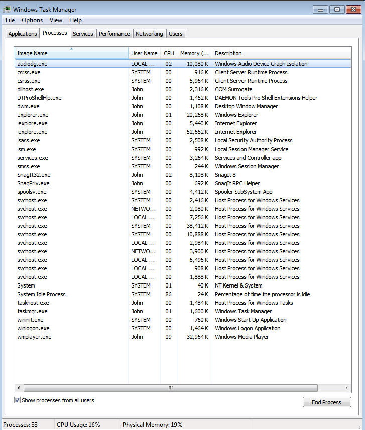

    Here is the tasks when running the same video file in windows media player
  14. So you're now seeing VLC using about 30 percent CPU and no other programs are using any significant amount? That looks about right. You're still getting jerky playback? This won't fix tearing.
    Apr 2010
    London
    Yes
    VLC is using about 30% and still get the tearing problem
    Yes still getting Jerky playback
    And yes still getting tearing ??

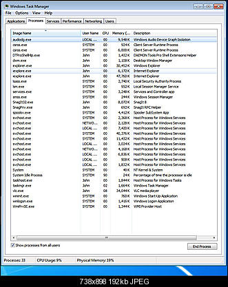

    I will post results using your test files to, this playing bff.mpg (I think its much less due to the video being not so complicated and no sound ?)
