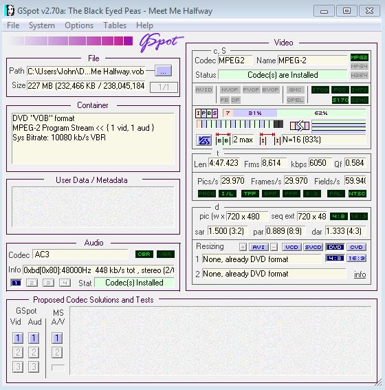

    here is the gspot details from the jerky file that was ripped with dvd decrypter
    all my NTSC that play jerky are not 23 frames but 29.970 ... does this matter ?
    also I notice that audio is at 48000 should this not be 44100 ?? could this be an issue

  5. Originally Posted by Johnnysh View Post
    It shows this one encoded as interlaced 29.97fps, which is true of most NTSC music videos.
    48000Hz is required for DVD. I expect all your DVDs are like that. Where you see 44,100 is on CDs.

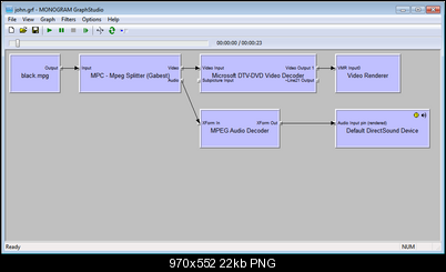

  8. Try using GraphStudio to render you files. See if it is jerky there too. Then examine each filter to see what is being used. See if there are any options you can change.

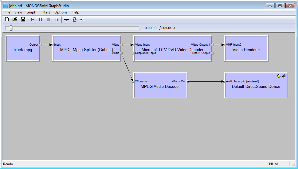

    Thanks for telling me about graphstudio
    what a great program !, still getting my head arround it but it looks real cool
    and compliments gspot
    this should give me lots more info
    thanks

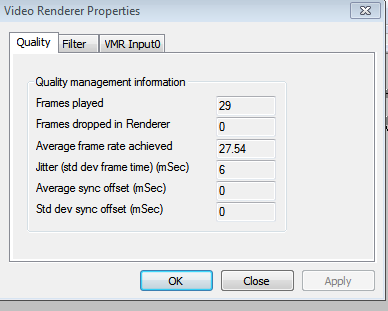

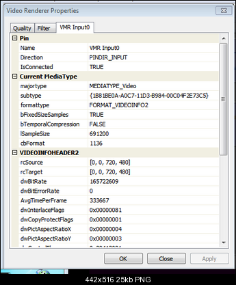

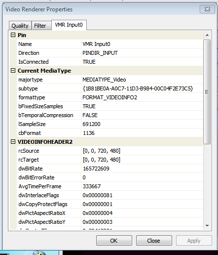

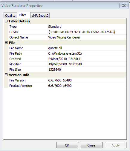

    ok Im not really sure what I am looking at or looking for but i clicked on the last stage of the video (video render) and took a screen capture of the results, not sure if this helps anyone
    thanks anyway

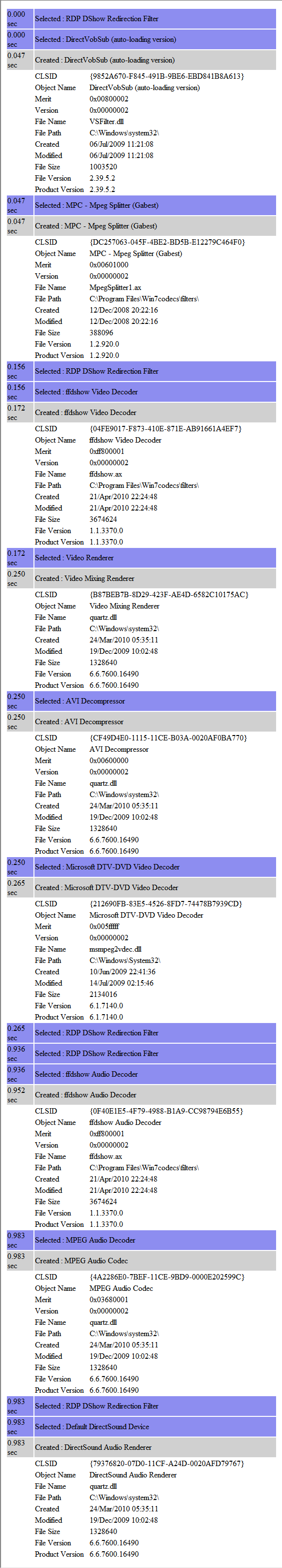

    don't know if this will help either, this is a report generated

  23. Here's a simple bob of the Black Eyed Peas video as Xvid AVI. Does this play just as jerky? The MPG and the AVI play about the same on my XP and Win7 computers. It's jerky because of the blended fields and poor frame rate conversion. Normal NTSC DVDs do not look that bad. What is the refresh rate of you monitor?

    The Black eyed pea video is mpeg 29.97 video and doesn't playback jerky at all in Vista Home Prem 32 bit, Windows media player works fine. Somethings goofy with the playback, has anyone tried playing it in VLC ?
  25. It is jerky. Watch the stars as they rotate around. The motion is not glassy smooth and it cannot be because of the problems with the file. Well, NTSC from film sources is never glassy smooth but this video is worse than normal. The jerks are of very short duration (a frame or two), a few per second. They might be described more like flickers. Compare it to this MPG file (soft pulldown):
  26. Member
    Aug 2004
    PA USA
    The Black.mpg plays back fine as well, in Windows Vista 32 bit, Windows Media Player, Media Info reports it's an Mpeg at 29.97 9200 kbs, no problem here.
  27. Member
    Aug 2004
    PA USA
    i'm sorry it might be jerky or flicking frames for you, but they are all glass smooth on my systems, 1 system is a dual core laptop with Nvidia graphics, one a quad core desktop with ATI graphics, I've tried them all in Windows media player 11, and VLC, and they are all glass smooth for me upon playback. I don't have an answer as to why they are playing back the way they are for you, sorry.
