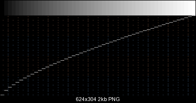

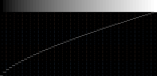

  4. evenly spaced shades of gray and a graph:

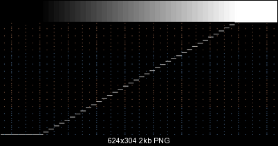

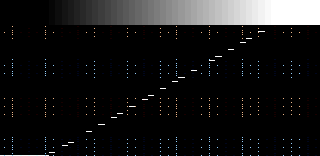

    contrast increased (darks darker, brights brighter, blown out at both ends):

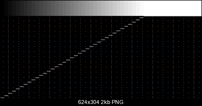

    gamma increased (dark lighter but black still back, lights lighter but not blown out):

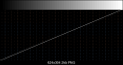

    Some programs use the term contrast to mean gain (black still back, everything else lighter, brights blown out):
    Gain and contrast are basically the same thing except gain stretches intensities from the bottom, contrast stretches intensities from the middle.
