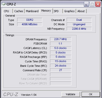

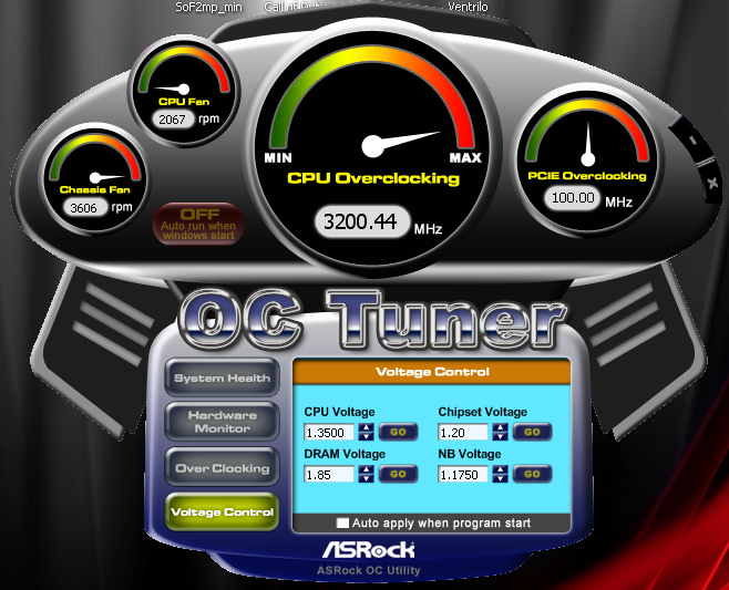

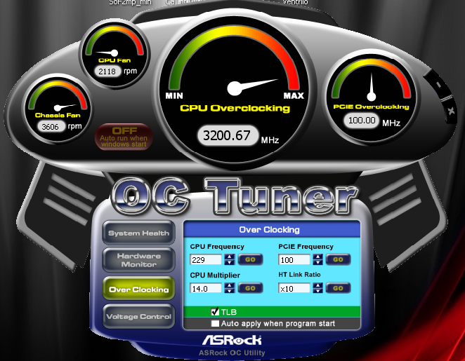

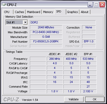

    I overclocked my AMD Athlon II X4 630 to 3.2GHz (stock 2.8GHz) using my ASRock OC Tuner which is one of my motherboard utilities. It runs smoothly which is great.
    Here's where I get confused. I upgraded my RAM to G.SKILL DDR2 1066 4094MB but look at the speeds in the photos
    The frequency was 200 before I overclocked the CPU and went up to 228 when I overclocked. I'm not 100% sure but it doesn't seem to be running fast enough, or I may be reading it wrong??
    I'm hoping to get my RAM running at stock speed or even faster, I know that OC is a long process but maybe if I could get info on how to get it stock speed.
    My mobo allows me to set it to 533MHz ddr2 1066 in bios but the trc timings only go to 42 if I can remember right. And nothing changes with those settings. So am i doing something wrong?
    I also set the volts in bios to 2.08 but the screen shots are with it set to 1.8 (asrock reads it as 1.85)
    So do I need to adjust my multiplier, frequency...? Or am I way off track. I'm not too good with this stuff.

  4. Real world performance is hardly effected by minor differences in memory clock speed and RAS/CAS delays. So even if your memory is only running about 915 MHz instead of 1066 MHz it's not costing you much of anything. Probably less than 1 percent.
  5. Gamer and Builder HotDamn!'s Avatar
    Nov 2009
    But it only seems to be running at 228 MHz.
  6. No, there's a 4x multiplier on that clock.
  7. Gamer and Builder HotDamn!'s Avatar
    Nov 2009
    Ahh thanks

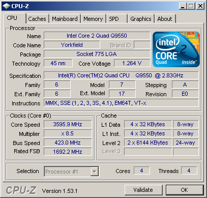

    Sometimes in order to get a stable cpu overclock the ram speeds have to be lowered. Also it depends on the brand/type of ram as well as the motherboard. Some brands/models of motherboards and ram are not very good at overclocking at all. This is what I've learned so far in overclocking. Some GSKill ram kits aren't good overclockers but their PI series and Redlines are excellent from what I've read. I've been using Mushkin ram lately and have had good results. I do own a few GSKill ram sets too. I even have my parents pc using Corsair ddr2-800 ram that's overclocked along with a overclocked Intel wolfdale E6300 cpu.
    You could try upping the cpu frequency first to like 235 and see if it's stable by running OCCT and Prime95. If you're a member over at overclock.net post your questions on overclocking your 630 propus and asrock mobo. Members there can give you pointers as well. Getting your cpu overclock to be stable should be done first. I'm sure other members like redwudz will add comments as well.
    Take a look at my Intel Q9550 overclock as the ram speed is DDR2-1066 but it's really running lower than that. I'm using a Gigabyte UD3P mobo with that Q9550.

    Your using 1066 RAM so you should be able to run at 533 in CPUZ. I don't think Asrock has memory multipliers in BIOS. It uses speed settings-266-333-400,etc. You need to test which speed setting gives the highest memory speed with stable operation.

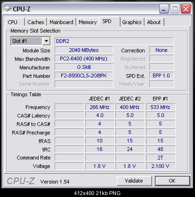

    Nov 2002
    What freaks me out the most is that it reads as PC2-6400 RAM when it should read PC2-8500 RAM.
    I've had it explained before that although it says the DRAM frequency is 533 Mhz that it's double that at 1066.
    I've also read somewhere that Gigabyte P35 boards don't support over 800Mhz (I finally got my BIOS reading 1066) even though they say they support 1200Mhz but that the P45 boards will with a BIOS update.

    ^^Yuh, go figure why it reads PC2-6400 ram when it suppose to be PC2-8500 ram...but if you see what my ram is set at it's only 1014....from what I've learned/read about overclocking sometimes in order to get a stable overclocked cpu the ram settings have to be lowered....I've had this Q9550 system for a few years now and haven't had any problems with it. It's my video encoding pc.
    My parents pc is running my old Gigabyte P35- DS3L mobo with a overclocked Intel Wolfdale E6300 cpu and 2gb ddr2-800 Corsair ram overclocked to either 900mhz or 1000mhz....I can't remember which it is but I know it's not running at 800mhz.....go figure huh!

    It's still pretty confusing since my mobo doesn't have a multiplier for my memory, or I just can find it.. So idk if I'll get a complete stable setup since my trc timing is 48 (suggested in cpu-z for 533) but my mobo only goes to 42 so I left it at auto and it gets set to 18..hmmm hope it doesnt mess me up too much.
    At the moment I'm just raising the CPU Frequency to check stability with Prime95. Man I'm stumped but want to get it clocked high and stable sooo bad

    I did see your thread. Your overclock could be limited because of your motherboard. Some motherboard bios options are very limited when it comes to overclocking. Also the GSKill set you have doesn't overclock very well. If you can just save up some money and buy a new motherboard that has better options when it comes to overclocking. Try to stay one step ahead of the game so you'll have room to upgrade later. I try to do that when I buy computer stuff. They'll always be a faster cpu that will come out 3 - 6 months after you buy one.
    Don't feel bad because I'm still learning as well when it comes to overclocking. Most of those members at overclock.net are teens/college age who are hard core gamers.

    Take your overclock back to what was stable for you. As I mentioned it's prolly your mobo that's holding you back. The 770, 785, 790 & 890 chipset mobo's are good overclockers. I believe Gigabyte & Asus are the more popular mobo's that people choose for overclocking. Save some $$$ and buy a new motherboard if you wanna overclock higher than 3.2. I prefer Gigabyte and used to use Asus alot during the Pentium 4 and socket 462 days. But Asus quality control went downhill so I switched to Gigabyte and never looked back.
    Here's the mobo that I'm using with the 630 Propus.
    http://www.newegg.com/Product/Product.aspx?Item=N82E16813128419
    As for getting Phenom settings some mobo manufactures have updated bios firmware to accomodate the new AMD 6 core cpu. You could check the Asrock website if your mobo supports it.
    I *think* that's because the highest JEDEC-spec'd clock rate is 400Mhz, hence PC2-6400. The 533MHz is listed as an EPP timing (Enhanced Performance Profile), which is not a JEDEC speed for that RAM.
    Kinda confusing, since having the EPP timing G.Skill seems to be able to label the part with "-8500", this indicating the highest possible speed/bandwidth. But the highest that conforms to the JEDEC spec makes it technically "-6400" memory.
    That's my understanding, I'm sure someone more knowledgeable can correct or expand on it.

    HotDamn I read through your Asrock mobo manual....you're only able to run DDR2-1066 if you use a Phenom cpu and you're not using one....thus you aren't able to use DDR2-1066 ram....another easy way out is to return the GSKill DDR2-1066 ram and get some GSKill DDR2-800 or Mushkin DDR2-800 ram.

    This maybe a cheaper way out to get your overclock stable with that Asrock mobo or go with your latest plan to sell off that pc and mobo on craigslist. Then buy your new AM3 Gigabyte mobo and ram.
