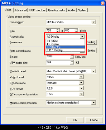

    When you setup the Tmpgenc settings, did you select 16:9 for "aspect ratio" on setting/video tab ?

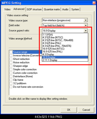

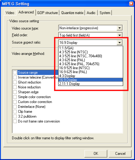

  3. You have to specify both the source's aspect ratio and the output aspect ratio in TMPGEnc.

  12. I already told you:
