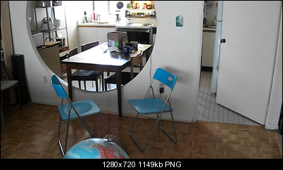

  6. Originally Posted by edDV View Post
    Post a sample
    here it is:
    http://www.sendspace.com/file/k5qlqv
    check out my trip hop beats: http://www.youtube.com/user/octeuron

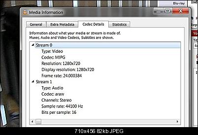

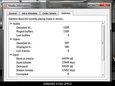

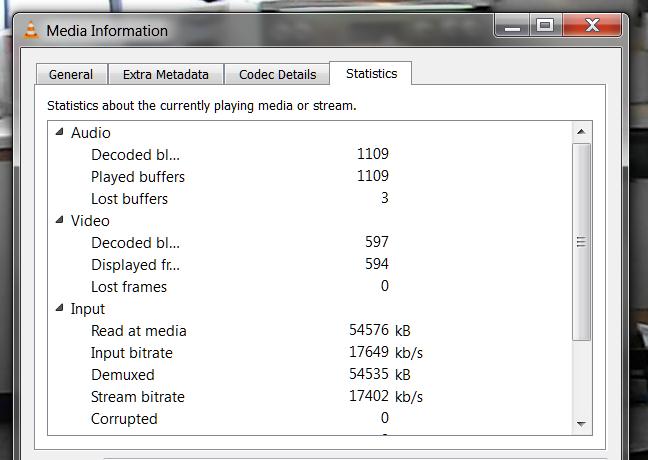

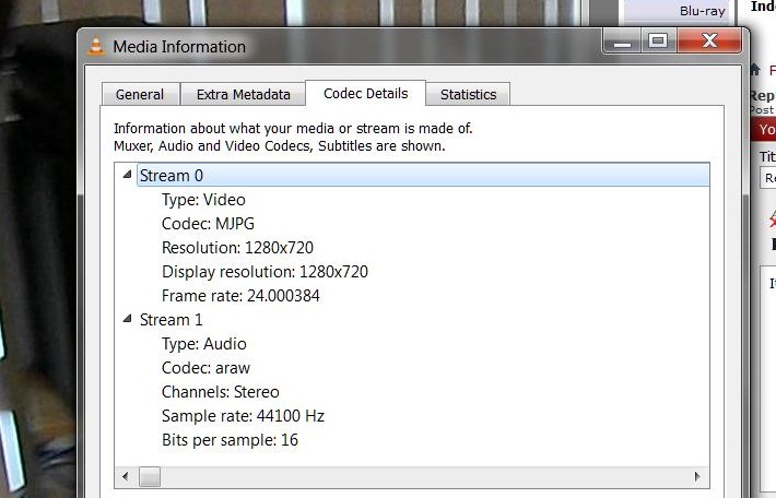

  8. Member edDV's Avatar
    Mar 2004
    Northern California, USA
    It plays fine here too in VLC 1.05
    Media info under Tools shows MJPEG at 24fps.
    The clip is a good example of why 24p is not recommended for hand held.

  9. Originally Posted by edDV View Post
    are the fold-up chairs yellow or blue? (should be blue)

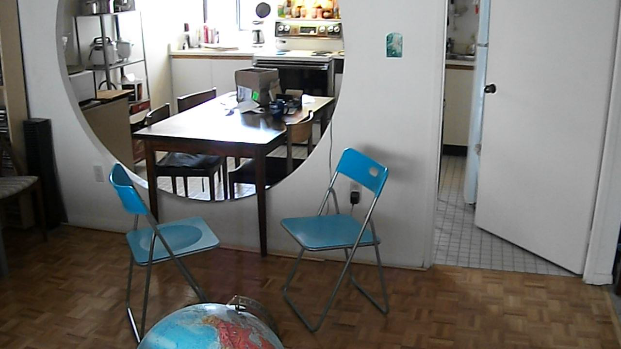

  10. Member edDV's Avatar
    Mar 2004
    Blue
    VLC snapshot. Click on picture for full size.
