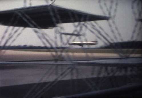

    When doing a home brewed film capture by pointing the cam at the projected image, there are double images where portions of two different film frames end up on the same video frame.
    If the video is capturing at a significantly faster frame rate - 29.97 frames vs 16 or 18 fps, why would the projected film ever have a chance to lay parts of two frames onto one of the video?

  2. NTSC Video cameras capture one field every 1/60 second. When that video is digitized pairs of fields are woven together into frames. What is happening is the film frame changed between the time those tow fields were captured. Then the two fields were woven together.
    I guess you're thinking that since the duration of each video frame (or field) is shorter than one film frame, then only one film frame can appear during that time? But the two are not synchronised, so a change of film frame can easily occur in the middle of a video exposure. (The underlying problem is not really to do with interlacing, a similar thing would happen with a progressive video camera.)

  7. TFM() will convert those half/half frames to full frames by taking a matching field from an adjacent frame. That will remove the interlacing but leave you with duplicate frames. TDecimate() will remove the duplicate frames (you have to specify the frame rate). Duplicate frames will screw up the deshaker.
    You could also use a deinterlacer (like Yadif()) instead of TFM() but that will leave you with more artifacts.
