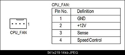

  21. Mod Neophyte redwudz's Avatar
    USA
    If you have a four wire fan, that's a PWM (Pulse Width Modulated) fan. But it will also work as a regular tachometer fan.
    This from my Intel MB manual of the PC in my Computer Details:
    1 = GND (Black)
    2 = +12VDC (Yellow)
    3 = Sense (Green) (Tachometer)
    4 = Speed Control (Blue)
    This is a different color code than a voltage controlled fan. And if your MB has a four pin fan connector, you can go into BIOS and select PWM fan control instead of voltage fan control. PWM has the advantage of precise fan speed control, from zero RPM to full speed and is more efficient than voltage control.
    EDIT: It sounds like you have a couple of wires reversed.

  22. Texan V Bot's Avatar
    Feb 2006
    Thank you guys, I did follow the pins/Ground,Power, etc and it's back on. I knew I came to the right place. Thanks again.
