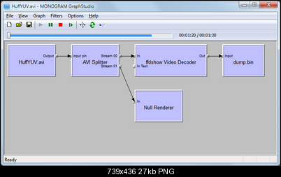

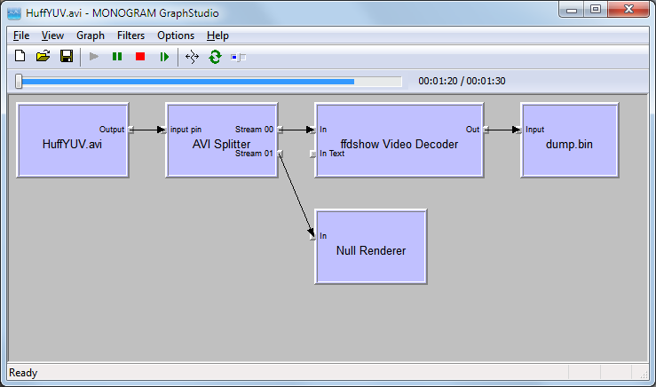

    A way to compare raw YUY2 data from different program is to use GraphEdit and the DUMP filter to dump raw YUY2 frames to a binary file:
    Of course you can also remux with VirtualDub in Direct Stream Copy mode.
