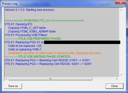

    Ok, Baldrick, something's up with the VOBs - as you can see from my connected post ( https://forum.videohelp.com/threads/320687-Changing-Audio-Tags-Chapter-Selections ) things did not go right. The existing VOB set has 22 cells, but the one I am replacing it with apparently only has 1. Is there an easy way to match the Cells for the new video to the existing?
  4. Originally Posted by DeathStalker77 View Post
    Yes, make sure and include the chapters list when authoring. You didn't say how you demuxed or how you reauthored. If you demuxed using PGCDemux it gave you a celltimes.txt file with the chapter points. If you reauthored using Muxman you should have loaded that celltimes.txt in File->Import Chapters.
