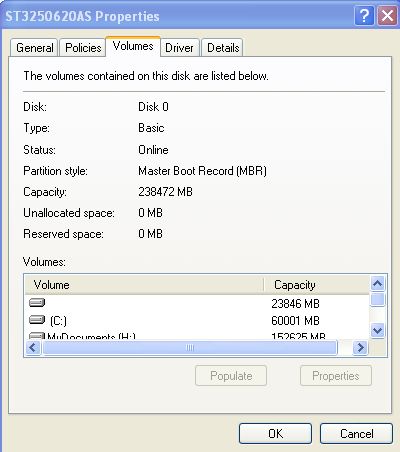

  10. Nelson37: My Main Drive is partition into three parts and I think I can prove it by right clicking each partition and selecting properties, when I pick the hardware tab it reveals they are all listed under "ST3250620AS". The partitions are "C: Local Drive" which is 58.5 GB, "H: My Documents" which is 149 GB, and "P: Page File" which is 1.95 GB. It seems my original drive is around 200 GB. I just went to "Device Manager" and found out something very interesting there is another partition that has no name and it is about 24 GB and it is listed before the "Crive". I am attaching a screengrab, but please note "P: Page File" is last in the list and it does not show up in the list becaue one has to scrowl down to see it as there is only room for three listings in the display window.Click image for larger version

  11. Well, good news/bad news. The E: partition does not appear to be on the boot drive, that's good.
    However, whoever set up this drive screwed up. Three partitions on a 250 Gb drive, boot part only 60GB, swap file on seperate partition on boot drive is pointless, 2 gb partition for swap file is too small, and 10% of your drive is unusable. Now that 10% may be used by the RestoreIt program, which brings up my absolute and total hatred for such programs that insert themselves into the partition structure. UNDER NO CIRCUMSTANCES WILL I INSTALL OR RECOMMEND SUCH A PROGRAM.
    If a customer wants or desires such a program, and is willing to pay me to do the work, I will refuse the work and turn down the money, and I am not exactly rolling in dough. I will not inflict such crap on one of my customers, they can get some high-school kid to to that.
    I would still disconnect the second and third drives and see if that affects the XP boot process. A failing drive, even though secondary and not containing the swap file, can account for many of the problems you have seen. Just disconnect the power and data cables to both drives, with power off, and boot a few times. Once is NOT enough.
    If this does not help, then it may be a failing c:, or it could just be the needlessly complicated partition structure coming back to bite you in the ass. If you take it back to the technician, tell him you want a simplified partition structure, as in ONE, ALL of the drive should be usable, and NOTHING repeat NOTHING not part of the OS having ANYTHING AT ALL to do with that partition structure. Also, if you want to increase swap file performance, then move it to a seperate drive that is NOT the boot drive.

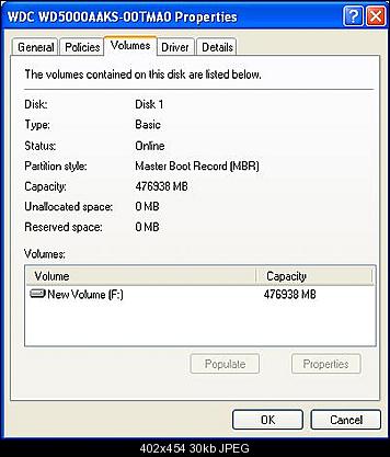

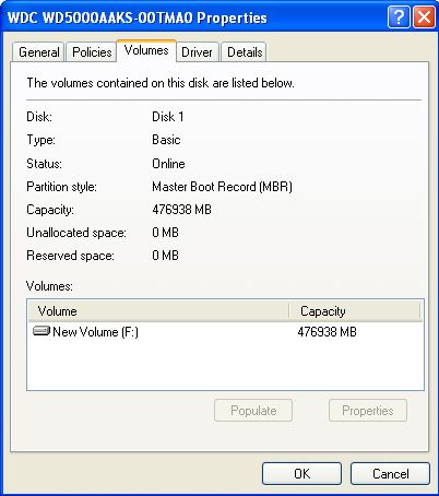

    I am attaching a picture of "Drive F:" which I am now capturing to. Here is the picture:
