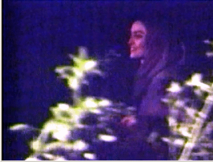

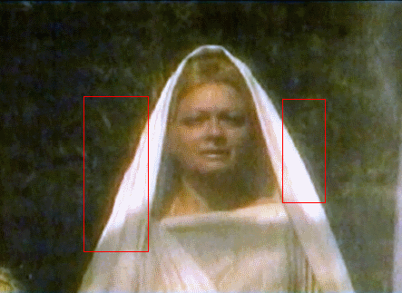

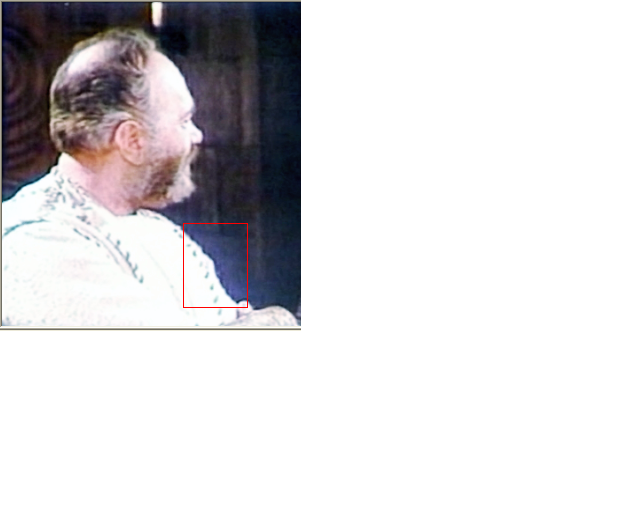

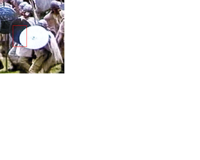

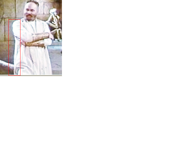

    Can anyone give me some hints about they ways to correct a video? I have the DVD but the original is some 40 years old...
    I named each picture according to eache identified problem.
    Thank you in advance.
    Best regards.

    That looks like an exposure issue, it has flare/blooming. I don't think it can be fixed digitally. The transfer process would need to be done at higher quality, with a better scanner, frame by frame, on the film.
    Not sure if I see chroma noise -- have to see video in motion for that.
  6. The "white halo" and "blue halo" problems can't be fixed as far as I know. The too blue shot can be fixed with some color filters -- like AviSynth's Gradation Curves, possibly with a chroma reduction/shift. The one you called "shadows" might be helped by a chroma shift. What really needs to be done: someone should go back to the negatives or film and start all over.
  7. Originally Posted by lordsmurf View Post
    ...someone should go back to the negatives or film and start all over.

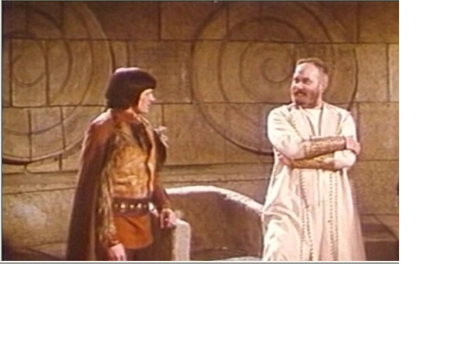

    First I would like to thank both of you for the time taken to reply as I've struggled for days to find some help for my issues.
    Second, the transfer of the movie to digital format once again is out of my reach, I try to correct what's already on a commercial DVD(the last yellowish picture is what the original looks like)...
    In other words BlindDeHalo3 and/or Dehalo_Alpha, or any DeHalo filters that might exist are useless for the above issues and I should accept the fact that I reached an editing limit?
    Best regards

    Unless you have a family member in this movie, it's not going to be worth your trouble to restore. It's too smeared to ever look significantly better. Those halos are too wide to fix. Have you looked for a better source?

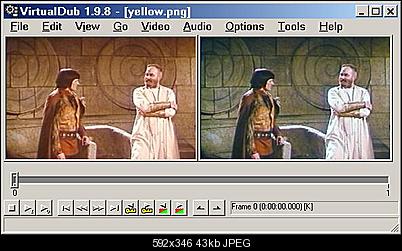

  9. I've never tried the dehalo filters with halos that large, only with halos that are a few pixels thick (usually caused by over sharpening filters).

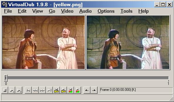

    The yellowish picture can be adjusted with gradation curves:
    It needs more fine tuning but that should give you an idea of what can be done.
  10. Video Restorer lordsmurf's Avatar
    Color correction might make the halos/etc look worse.
    On my calibrated monitor, the "fix" version on the right is still off -- just green instead of red/orange.
  11. Originally Posted by lordsmurf View Post
    Like I said, it still needs tuning. It's not my project, I'm not going to spend a bunch of time on it. And from that one shot there's no way of knowing exactly what the colors should be.
