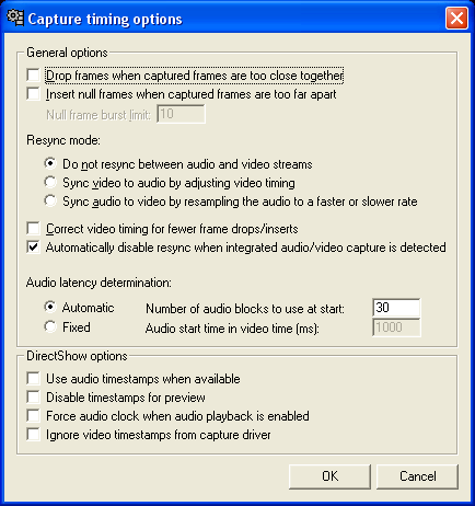

    When capturing, I am noticing that Sync/Current Error is all over the places. +/- < 10ms on average, but sometimes it jumps 30-100ms. When this jump occurs, that's when I notice the picture in the capture freeze slighty. VT adjust stays at +0ms.
    I read some stuff online that said this is the audio trying to stay in sync with the video, and VirtualDub is adjusting as it sees necessary to do so. It mentioned a setting for "sync audio to video" and "sync video to audio" that effects these things The info was from a much older version of VirtualDub however.
    Do I need to make some adjustments in regards to this, or is this normal when capturing home movie VHS.
    Jan 2010
    Here is the settings I was talking about. Should I be changing any of these?
    May 2007
    Romania
    Your settings are good when you take audio from a dedicated sound card. These setting are unnecesary for capture card with that have integrated sound ADC card like Theater 750. Here it is my setting:
