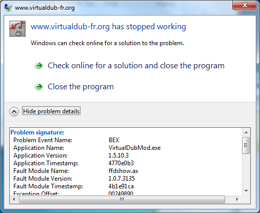

    The problem: VDM crashes on me. A screenshot is attached below. Here's the full report:
      Problem signature:
      Problem Event Name:    BEX
      Application Name:    VirtualDubMod.exe
      Application Version:    1.5.10.3
      Application Timestamp:    4770e0b3
      Fault Module Name:    ffdshow.ax
      Fault Module Version:    1.0.7.3135
      Fault Module Timestamp:    4b1e91ca
      Exception Offset:    00249890
      Exception Code:    c0000417
      Exception Data:    00000000
      OS Version:    6.1.7600.2.0.0.256.1
      Locale ID:    4105
      Additional Information 1:    ad89
      Additional Information 2:    ad8945dbe67920babe48c222e6fb524f
      Additional Information 3:    8a13
      Additional Information 4:    8a13f7f19fe897c48836a69cab9d963f
    Read our privacy statement online: http://go.microsoft.com/fwlink/?linkid=104288&clcid=0x0409
    If the online privacy statement is not available, please read our privacy statement offline: C:\Windows\system32\en-US\erofflps.txt

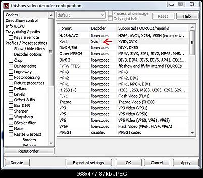

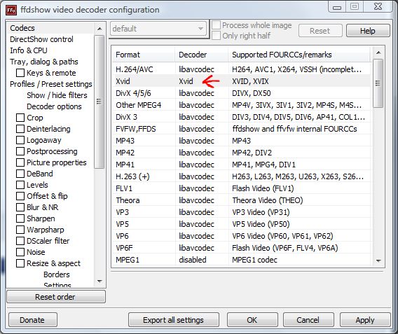

    ffdshow is designed to be capable of running alongside Xvid, if you prefer - note that in the picture I'm attaching, I've set the decoder for Xvid to... well, 'Xvid.' That tells it to use Xvid's dlls rather than ffdshow's for decoding Xvid.

    I don't normally have it set to do that, though. But other than that, I've never had a problem having both ffdshow and Xvid installed.
    Your version of ffdshow is a little out-of-date - the current version is r3356, I believe.
