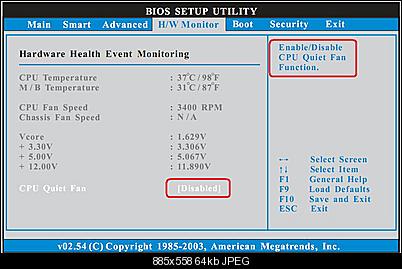

    Most MBs BIOSs just have a adjustable setting for a alarm if the fan quits or overtemp. The Motherboard and the CPU, especially newer CPUs, will throttle back the CPU or shut it down completely if the CPU overheats enough. I had a PC a couple of months ago that the CPU cooler mounts broke off and the heatsink was only touching a corner of the CPU. It would turn on for about ten seconds before the PC shut down. But I've had older CPUs from several years ago that would go up in smoke if that happened.
    There's several MBs under that model number. The shot from the BIOS here doesn't appear to have much for adjustments. It looks like the Cool and Quiet program can control CPU fan speed and seems to have a temp alarm there also.

    If the fan is noisy, I would replace it ASAP.
