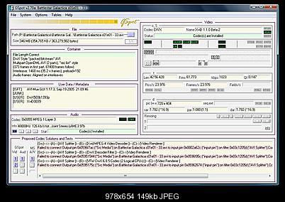

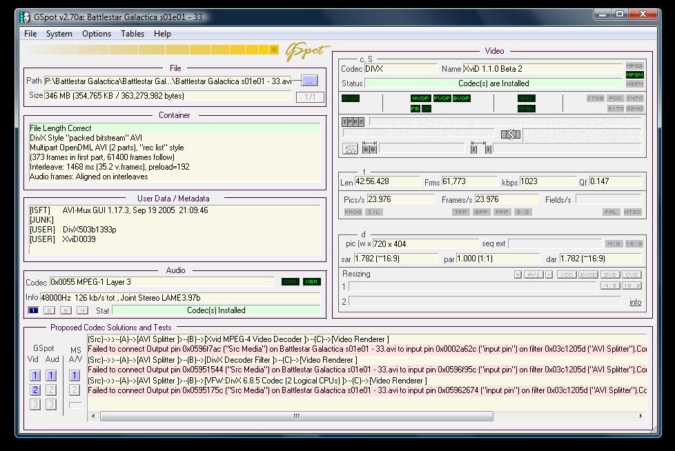

  2. What else does GSpot say about the video? Post a screen shot.
    Apr 2010
    Here is the screen shot.
  4. The 720x404 frame size could be a problem for some decoders. Some don't like mod4 (404 is mod4) or less. But all recent versions of Xvid and Divx should work with mod4. The only other thing I see that's unusual is the '"rec list" style' in the container info. I've never seen that before. Can you re-mux it with VirtualDub or AviDemux?
