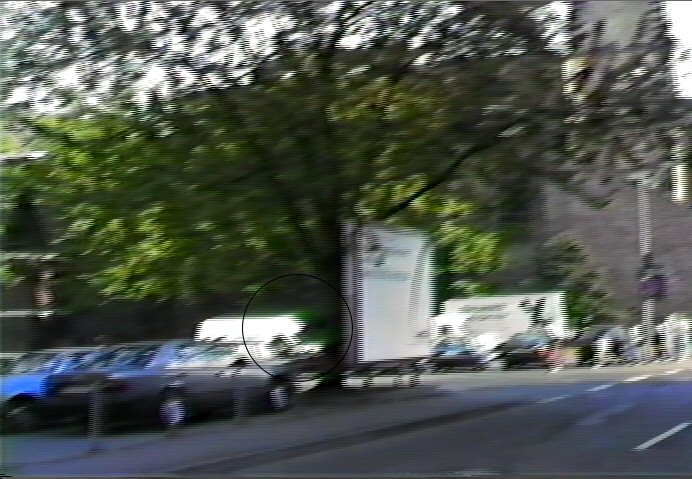

    One problem I notice is the "warping" on vertical things... like ilumination post or trees, also some "greenish" ghosts (what is that?)
    No idea what you mean - if no one else knows, maybe post a screen cap showing this?

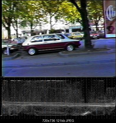

  5. As has been pointed out, you need a TBC to fix the horizontal squiggles. A used Panasonic ES10 or ES15 DVD recorder in passthough mode will work pretty well. There is a software TBC for AviSynth but it doesn't work very well It will likely make your problems worse, not better.
    Look into VirtualDub's Chroma Noise Reduction filter by Gilles Mouchard. That will reduce the flickering in the chroma channels.
    You may need to shift the chroma channels left by a few pixels. Flaxen's VHS filter in VirtualDub can do that. Or ChromaShift() in AviSynth.
    You have some very hard clipping of darks and brights (at the top and bottom of the wave form monitor):
    Look into your capture process and see if you can eliminate that. Doing so will get you more detail in the bright and dark areas.

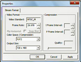

    Set your capture device to output YUY2 video. If you capture device has any options for clamping illegal luma and chroma values disable them. Don't let VirtualDub (or any other software) convert to RGB while capturing (don't use any filters while capturing). Set Lagarith to work in YUY2 mode.
    Originally Posted by Marto2008 View Post
    Any suggestion on the deinterlacing??
    Don't deinterlace unless you really have to. DVDs and TVs support interlaced video. If you really need to deinterlace (for uploading to Youtube for example) the best for most material is AviSynth's TempGaussMC_beta1mod() but it is very slow (a few fps on a fast computer). Yadif() (both in AviSynth and VirtualDub) is pretty good and not so slow.
  8. Thanks again for your answers.
    I do capture in YUY2, it is the only option available when I use the ATi 650 in Windows 7. I also use YUY2 in Lagarith codec. Am I not seeing something??

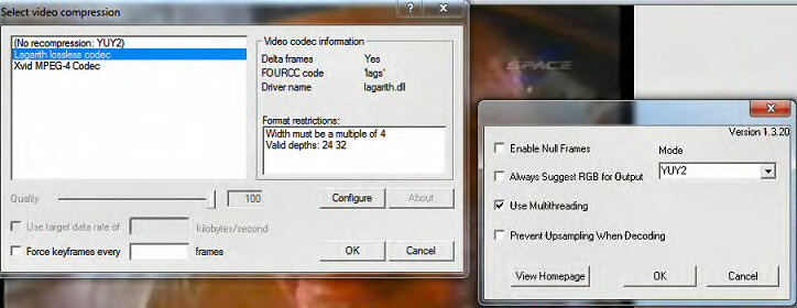

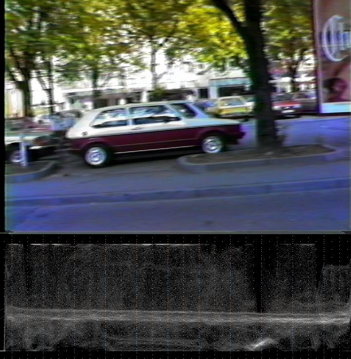

  12. I've been trying all sorts of configurations.
    My capture PIN and my Lagarith options both say YUY2.
    Now I'm using Avisynth Videoscope but it is really over my knowledge as I do not know how to identify LUMA clamping.
    My script:
    AviSource("original.avi")
    #ConvertToYUY2()
    Tweak(sat=0.8)
    VideoScope("both", true, "U", "V", "UV") # frame 3871
    Sorry for my lack of knowledge, maybe you can suggest me a guide on luma and chorma for dummies.
    Best Regards.

  13. In the Videoscope image I posted earlier, look at the top of the graph. Notice how it is all empty (all black, except for the tick marks)? And just below the empty area are some very bright horizontal line segments. Those bright spots are caused by luma peaks that should have been in that empty area but where squished down to fit below Y=235 (IRE 100). Video isn't supposed to have luma values above 235 but in practice often does. Camcorders and VHS tapes in particular.
    At the bottom of the graph there is another empty area with some bright segments just above it. That is the same thing happening at the bottom of the luma scale. Video shouldn't have luma values below Y=16 (IRE 0) but your did have a little.
    The cutting off of the peaks and valleys like this is called coring or clipping. I see in the config dialogs you have a noise reduction setting with "Luma coring". That may be where the coring was happening.
    Optimally, what you want is for the darkest parts of the video to be at Y=16 without any clipping, and for the brightest parts to be at Y=235 without any clipping. Are there any processing amp settings where you can adjust the brightness and contrast of the picture before capturing? Of course, not every frame will have the full excursion from Y=0 to Y=235. Adjust the the proc amp so that the brightest spots in the brightest shots are at 235, and the darkest spots in the darkest shots are at 16.
