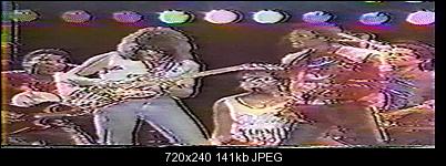

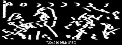

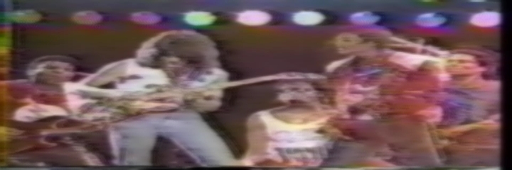

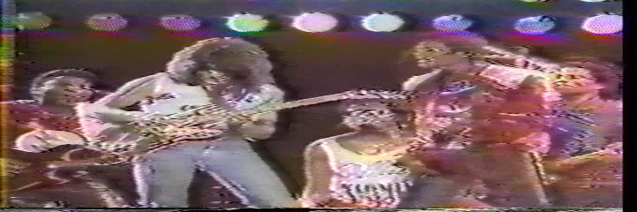

    I made a program to detect the halos. It works pretty well. Here is for example I mask I put a dehalo version over the original version for the white part:
    original version
    dehalo

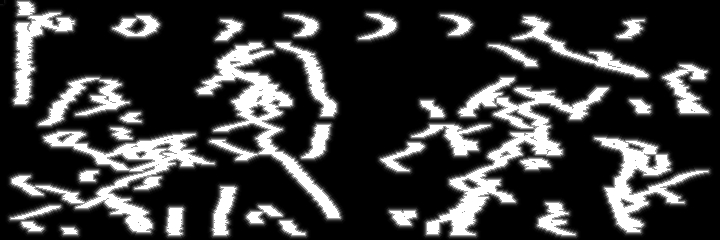

    mask
    corrected
    As you can see the result isn't very good because the blurred parts are very visible..
    I think it would be better to apply a progressive blur. Don't know if it exists but some filter that blur a lot whe you are pixels corresponding to the white of the mask and the more the pixels are dark the less the video is blurred. I hope you see what I mean
    Maybe you have other ideas, but I don't think that putting two videos one over the other is a good solution..
  3. of course, I'll make an other mask if I use a progressive blur.. The transition from the black to the white will be more progressive.
    jagabo, do you know if it is possible to blur progressively according to a such mask?
  4. Overlay() supports an alpha channel mask so you could blur your mask to get smooth transitions.
