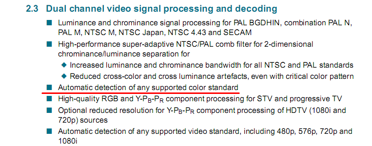

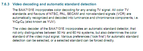

    Search on nxp.com for saa7162. Is a lighter version of 7164 without hadware compression engine, noise reduction, 3D comb filter.
    The problem for you may come when you want to record different standard inside of the same file/container. You can`t have NTSC and PAL inside of the same file. What you need is a application that start a new file when NTSC turn in to PAL or vice versa.

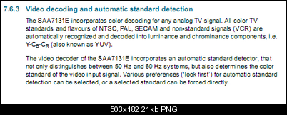

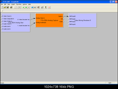

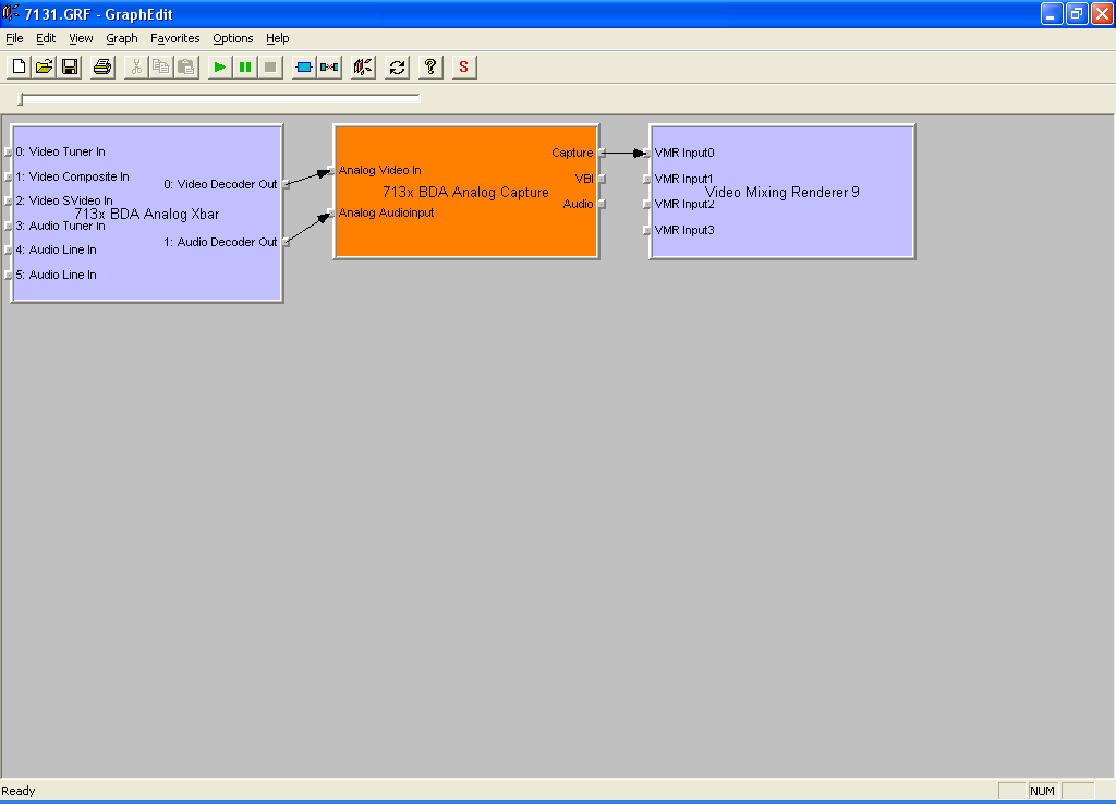

    I did a test to prove that Philips chipsets recognize and select the correct standard.
    I used: a capture card built around ancient SAA7131, one S-video cable and two video cameras as sources, one PAL and one NTSC.
    As application I built a preview filter with GraphEdit. I also tested with VirtualDub and the results are the same.
    I switched the cable between the two camcorders and the image appear right on screen, the board recognized every time the signal without any interference from me.

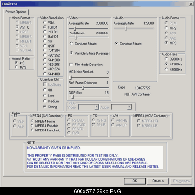

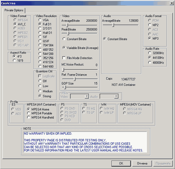

    The only chip available on a consumer card that is able to compress hardware MPEG4 it is SAA7163/7164, first one is single channel and the second is dual channel (can receive and compress two different inputs on the same time). Keep in mind that not all cards based on these chips can do that. Some manufacturers that have cards based SAA7163/7164 have inactivated in the driver MPEG4 option (Hauppage 2250). As far as I know, Asus is the third manufacturer that uses Saa7163/7164, but I don`t know if left valid MPEG4 option.
    Gonzalo, you have a lot of Philips chips that can handle automatic detection between NTSC and PAL but only one with hardware compression engine.
    SAA hardware engine options in Compro tuners

    GraphEdit preview filter

    The card used: Kworld PVR-TV 7131 SE. Capture card based on Saa7131x (x=1 to 5) are cheap and widespread.
    http://global.kworld-global.com/main/prod_in.aspx?mnuid=1248&modid=6&pcid=38&ifid=16&prodid=15
    The vast majority of Philips/NXP chipsets support automatic selection of color standard. Depeds on you if you will use or not.
