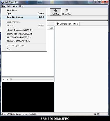

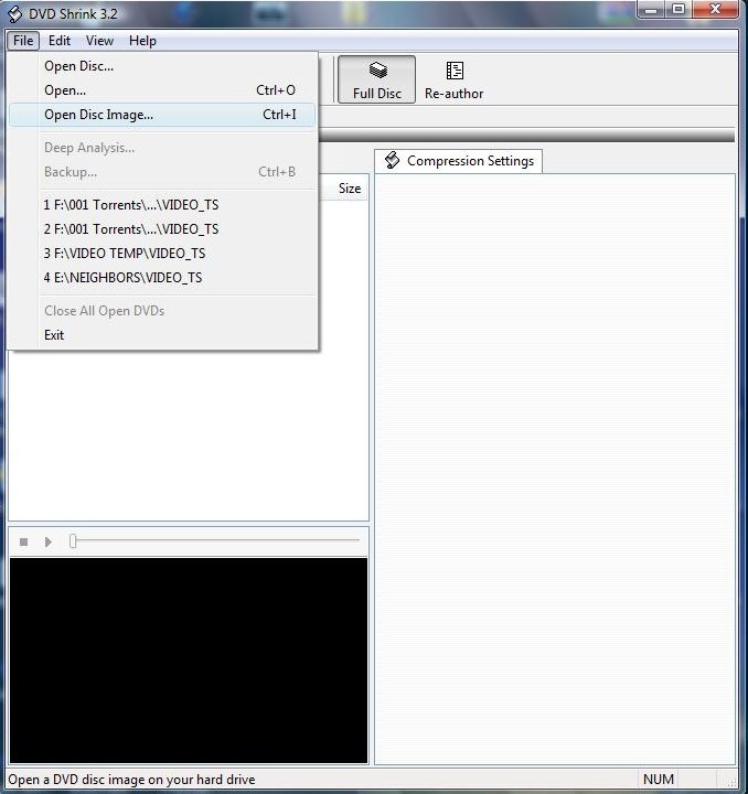

    Originally Posted by netmask56 View Post
    So, when I try to open the ISO image in DVD Shrink it just straight up tells me that it's an "invalid DVD Navigation structure."
    As far as I know DVDShrink won't handle ISO files but it will handle VIDEO_TS format
    Better look a little closer
    And just because it is already ripped to the HDD, does not mean it was ripped correctly
