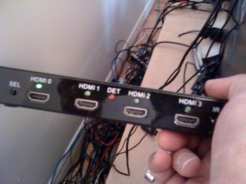

    It is not illegal to record legally purchased HD content for personal use. MUX-HD device is not illegal but may break the agreement to honor DRM rights when using US market HDMI and DVI interfaces . You can not go to jail selling this device but you could be open to lawsuits from Hollywood putting your company in the US out of bussiness. A bussiness wants to make money and not loose it later in court! TIVO went to FCC to fight AT&T and others to allow HD content use with their HD TIVO boxes. It was probably cheaper and quicker to go that route than sue every cable company.
    There is law in the US called “fair use” http://en.wikipedia.org/wiki/Fair_use and the “Audio Home Recording Act of 1992” http://en.wikipedia.org/wiki/Audio_Home_Recording_Act That allows anyone to copy for personal use legally purchased content.

  26. Originally Posted by stevon111 View Post
    As far as I can tell it has been "disappeared" from the US market. Places like Monoprice and Curt Palme no longer list it.

    Your'e right not to beleive me check it out! http://stream-recorder.com/forum/legal-record-video-streams-can-considered-piracy-t2036.html I own a MUX-HD, a great little device for sure. What is your system like? How do you capture cable provided HD TV?
Name:	moome MUX-HD PCB ver 5.jpg

    It is available just not in the US, you have to send away for one. $285.00 so it aint cheap but was worth it for me not to do digital to analog and back to digital again for storage. Can PM you if your interested
  29. Originally Posted by stevon111 View Post
    But no longer available for sale in the USA. Even Moome no longer lists it or any other HDMI+HDCP-->HDMI strippers.

    Yeah, I don't know how long it takes to get here from China but you can still buy it if it's worth your trouble. For most it seems not worth it. They are sold also in other countries and the new version MUX-FHD doesn't split off the audio from HDMI, sound will go through HDMI out. Didn't feel like waiting, toslink out is OK for my use.
