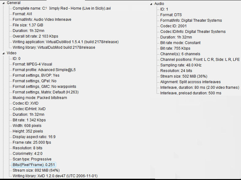

    Here's the tree info
  5. Always Watching guns1inger's Avatar
    Apr 2004
    Miskatonic U
    The audio is DTS, which is unusual in an AVI file, and not supported by many players. The PS3 only plays DTS from authored DVD or Blurays. Simplest solution would be to use AVStoDVD to convert the file to a full DVD Video structure. It will keep the DTS audio, and the results will be playable in the PS3.

  6. The DTS track is quite surely taken from a BD, because its resolution is 24 bit (DTS-ES), while DVD standard accepts only 16 or 20 bits DTS streams.
    Bye
    MrC
    AVStoDVD Homepage
  7. Always Watching guns1inger's Avatar
    Apr 2004
    Miskatonic U
    Missed that bit - convert to AC3 at 448kbps
    Read my blog here.

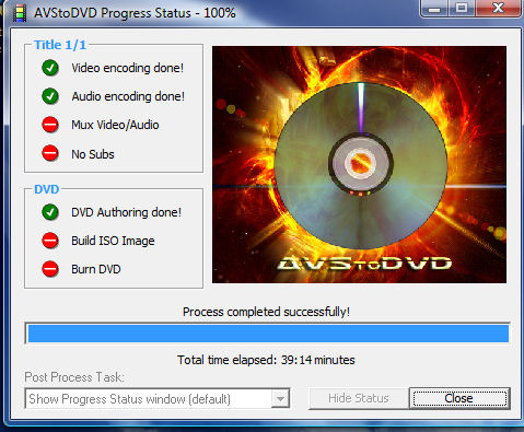

    Tinkered about,but no joy..always the sound is the problem tried AVStoDVD.

  11. Always Watching guns1inger's Avatar
    Apr 2004
    Miskatonic U
    Did you actually try to play the resulting output ?

    Dec 2008
    To be honest,no,i did try to open one of the files with nero showtime,but there was no sound.
    I have now burnt to a dvd disc using nero,and it played fine in the ps3 but no sound in my normal dvd player.
    I appreciate all the help from you guys,and just wondered if now,
    it would be possible to use this burned copy to make an avi file so i can store it on the hard drive attatched to my ps3,
    if not,then at least i have the dvd to watch..thanks.
