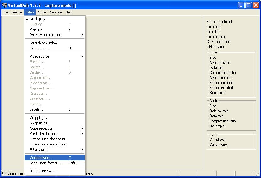

  6. Member pirej's Avatar
    Mar 2008
    Macedonia
    Virtualdub it's self doesent have a tv sheduling option.
    virtualdub-DVR
    capturing
    Someone else has explained the procedure allready
Name:	video compresion.JPG
