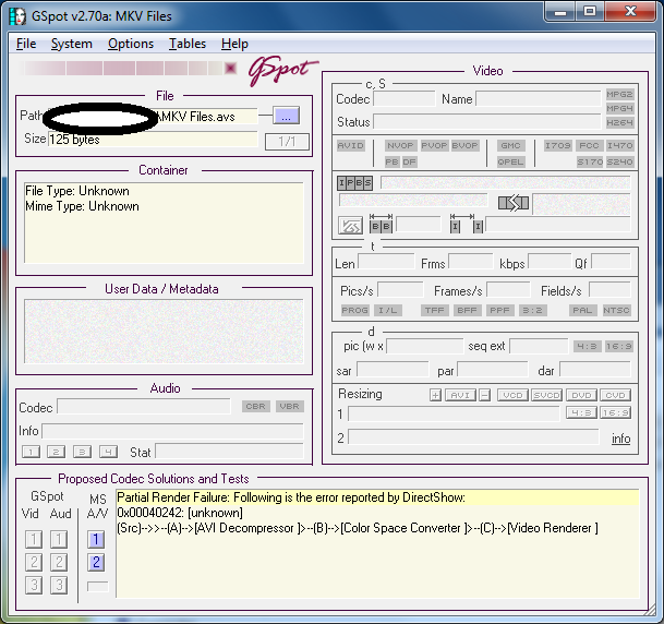

    So I open up the original MKV File in GSpot and it said "Render OK. The following combination of filters was used:" but there was no list below it. Strange. This file plays perfectly well on the computer though.
    So then I open up the AVISynth Script in GSpot. It says some things I don't understand. As far as I understand, it says the video is not playable. But this is not true: the audio is the real problem. A screenshot is at the bottom.
    I hope this helps. Is there an easy way of solving my codec problems? Or should I try to avoid headaches and just stick to what works for me?

    I'm not sure about the first but I'm gonna guess there may be conflict on what decoders are being used cuz of the codec pack installed. Most informed people just install the codecs they need and avoid codec packs. FFmpegsource is most likely working on that file of yours cuz it is using the dll in your avisynth plugins folder to decode that file. You can check to see what codecs are installed in your system through gspot: system-->list codecs and other filters.
    When you ran the original mkv file through gpot and used "proposed codec solutions and test" by pressing 1 and 2, did a little video window pop up playing the file? And what player do you use to play mkv files? If it's a player that has internal codecs that could be why it's playing correctly but having problems with avisynth.
    As far as opening up the avisynth script through gspot it's kinda pointless as you want to use gspot on your file natively. Avisynth on-the-fly decompresses your file.
    I don't know what else to tell you as far as the file you are having problems with. Cuz I downloaded that sample of yours, used directshowsource in avisynth, tested with mpc, and actually used your method by importing it into vdubmod and converting to xvid/mp3. So your method works on my system and all I have decoding the file is ffdshow. So my only recommendation is to uninstall the codec pack and just install the codecs you need, or you can most likely get by on using ffdshow altogether.
    Yes. It played it perfectly with video and sound.
    I thought that would figure out any codec conflicts when the original working MKV file gos through AVISynth. Oh well.

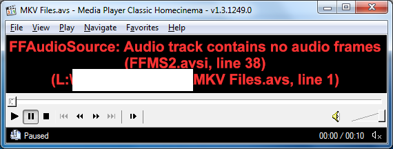

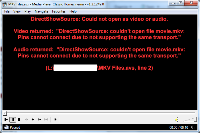

    However, I have a problem opening the AVISynth file. When I try DirectShowSource, it gives me an error. At the end of the post is a screenshot.
    When I try the second method of FFMpegSouce2, it gives another error. The second screenshot at the bottom is it.
    I am messed up right now. I had a solution, but to eliminate the codec problems, I ruined it... How ironic. But I still have hope. So what do I do know?
    You have to install the haali media splitter which are used for mkv files. MPC I think has an internal one so that's probably why you are able to play the file but not open it in avisynth. See if that will work. Also if you plan on opening flv files in avisynth you will need the flv splitter
    I don't know about this one...I'll have to see. I never tried this way with your file
    Thanks! That works. However, it's strange: there are 2 Haali tray icons and two ffdshow icons. Of course, the two icons for each are for video and audio individually. I don't think the two are doing the same job though. A quick Google search led me to conclude that Haali "splits" the file for ffdshow to "decode." So essentially, I am not wasting computing power doing the same job twice.
    I will try it too. I am not at my computer right now, so the results will come in later. I think Haali will make it work though.
    OK. It works... as long as Haali is installed.
    So to conclude (mostly for people in the future with the same problem):
    • Codec packs messed up my system
    • The conflicts in codec packs make encoding nearly impossible
    • One should install only the individual codecs they need
    • Haali is needed to "split" MKV files for the codec to decode
    Yea just to confirm I tried it on your file and it works also. It's actually very versatile and can load a lot of formats but I would just use it as a secondary resort and just stick with directshowsource.
