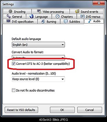

  11. Mod Neophyte redwudz's Avatar
    USA

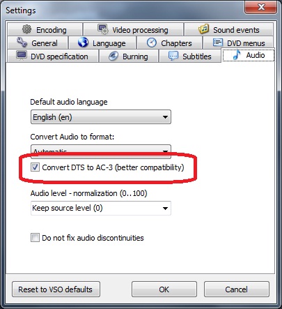

    I think Moontrash may have put up the wrong tab. How about this one:
    If you don't see it there, what version of ConvertX are you using? This shot is from ConvertX 3 V3.3.4.106
    EDIT: Also, when you end up with a file that doesn't seem to have audio (Or video), drop it into MediaInfo, Tree view, and it will tell you most times if you have audio and video and what formats they are.

    Oct 2006
    The version iam running is convertx2dvd 3.0.0.1 and this version is not showing this tab
    Is the a way for me to download the version you are showing for free
