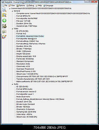

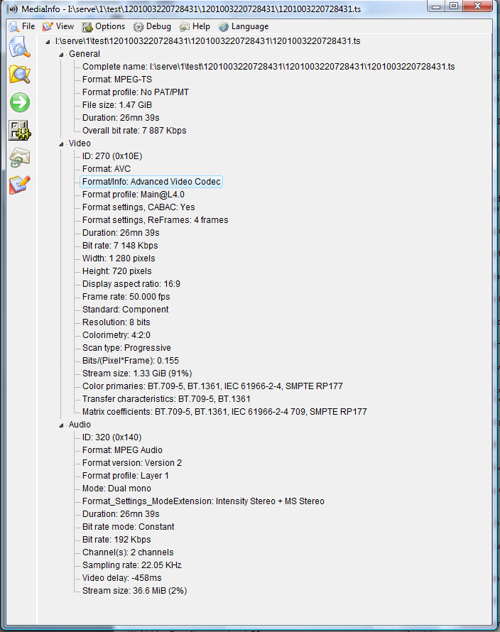

    Opening the first .ts chunk using Mediainfo shows that:
    - The container is MPEG-TS (No PAT/PMT)with 1 video stream (AVC) and 1 audio stream (MPEG Audio).
    - The video stream is 7,148 Kbps 1280*720 (16:9), at 50.000 fps, AVC (Component) (Main@L4.0) (CABAC /4 Ref Frames).
    - The audio stream is192 Kbps, 22.05 KHz, 2 channels, MPEG Audio (Version 2)(Layer 1) (Dual mono/ Intensity Stereo + MS Stereo).
    Videoredo opens the appears to video file, but only for each chnuk (about 26 minutes long) rather than the whole recording. However, while it will open the video, it plays no audio. When I try to open multiple chunks, the join option doesn't seem to join them and it dives a message that the audio format isn't supported. When I follow its recommendatio to do a "quick stream fix" it thrashes the machine, plays a few seconds of sound, then crashes.

    This is the full output in case it's useful

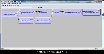

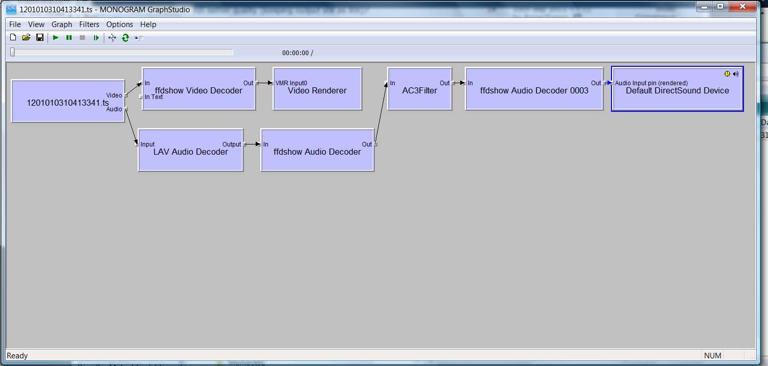

    No, video is not the problem. I have been playing around a bit more and have made some progress. Firstly I have discovered the properties can be found in Media Player classic, and are as listed below. Possibly more usefully, I have discovered that both video and audio will play in Monogram Graphstudio, and it gives me a graph "which puzzles me a bit" of the decoders needed - and seems to show that a combination of LAV audio decoder, ffdshow audio filter and an AC3 filter is what I need - but I am at a loss as to how to use this to create a conversion process.
    Both the data from MPC and a screenshot of the graph are as per below.
    I'm really hoping that some of you with more technical skill than me can advise how to use this information to convert the video into a more mainstream & editable format. I have pretty much exhausted my meager knowledge, and this is really starting toi irritate me.

  20. If your graphstudio graph looks like that now, any program that uses directshowsource() in avisynth should be able to convert it now
    If you right click the first box and look at the properties, check if it's haali or lavf splitter - your recently installed codec pack probably installed the correct splitter that you were missing
    So something like xvid4psp, megui should be able to convert the file . or You can make up your own 1 line script and use vdub or any program that accepts avs

    Nope, xvid4psp and megui still won't work - I get an output file with video and no audio.
    It plays fine with video and audio in graphstudio, and I can save the .grf file. However, when I try to use this in MeGUI I get the following error:
    DirectShowSource: GRF file does not have a compatible open video pin.
    Graph must have 1 output pin that will bid RGB24, RGB32, ARGB, YUY2 or YV12
    Which I can't seem to get past.
  22. Remove the last filter (renderers) in both streams. But if I recall correctly, DirectShowSource() on a GRF file will only get video. You may have to use two GRF files, one for audio, the other for video. Send the unused stream to the Null Renderer.
  23. jagabo is correct; if you are manually constructing a graph, you need to remove the last pin (renderer) and use a separate grf for audio & video
    use audiodub in the script
    e.g
    vid = DirectShowSource("video.grf", audio=false)
    aud = DirectShowSource("audio.grf", video=false)
    AudioDub(vid,aud)
    Did you just try DirectShowSource("video.ts") on the video (without a .grf)?

  25. Your sample works fine with graphstudio, and you can convert both video & audio with the method outlined above . (feed the .avs into any program that accepts avs scripts e.g vdub, megui, xvid4psp, etc. etc...)
    You need lav splitter in the chain to split the transport stream, and lav audio decoder to decode latm aac audio . But your screenshot shows you already have that . If you right click the 1st box and select properties, I am willing to bet it is Lav splitter
    Delete the last renderer box (DirectSound Device), and everything after lav audio decoder as well as the entire video chain for the audio.grf . It should just show the 1st box and lav audio decoder with empty output pin
    Delete the entire audio chain and the last renderer box for the video.grf chain . It should just show the 1st box and ffdshow video decoder with empty output pin
    Post your error message if any
