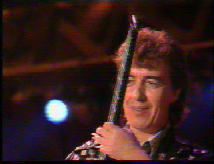

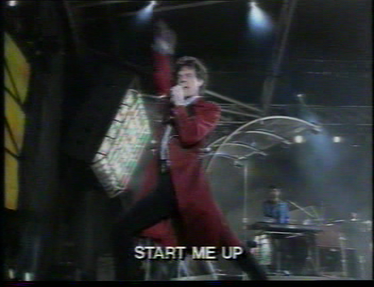

  19. In the meantime I bought a Datavideo TBC-1000. I also bought a Philips VR1100 VHS (30 euros this time!), which seems to be a JVC clone of some sort: built-in TBC/DR, etc. Sadly, the latter can't be used as a passthrough (how I tried!), but works great for my VHS tapes.
    Anyway, the TBC was said to fix the JVC/VCC recording issues and I'm pretty glad to say it does! The DR-M10SE records without any interruption now and the "digital static" before the recording is gone too. Thanks Lordsmurf!
    Some findings along the way:
    • The VCC VCR (without external TBC) does never ever generate a copy-protection signal, and I came across some really horrible tapes. Could it be it has some sort of built-in TBC too? I spoke to some guy, who claimed that "back in the days", one could throw a VCC recorder in the chain to beat copy-protection. But I don't take his word for it.
    • The VHS VCR (without external TBC) often causes M10 copy-protection "blockage" between tapings / on unused portions of the tape.
    • The VCC noise suppression I mentioned in my first post has to do with audio, not video.
    • On another forum, they told me that the (great amount of) noise is mostly inherent to the VCC system. Tapes can be flipped, so only half of the tape is scanned during each side pass. Less space for data, faster degradation, more noise; something in the lines of that. One also said replacing the capacitors of the VCR power supply could help, but I'm not going there yet.
    • I'm in PAL-land, so half D1 is 352x576. Is this a significant difference in regard to recording modes / time?
    • The M10 also craps out when recording off my Videopac, a 70's console sold in the US as Magnavox Odyssey2.
    • A somewhat remarkable side-effect of the TBC is that the chroma-noise seems less worse. How could this be? Also, it's clear that it darkens the video and renders it a bit less sharp. Other than the TBC, I am also using different cables and a SCART-to-composite converter, since the TBC doesn't have a SCART input/output.
