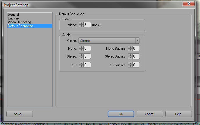

  1. In your screenshot where the 1st heading says "general", the 4th heading says "default sequence", i think that tab corresponds to sequence settings
  2. Ah ok. Here it is.

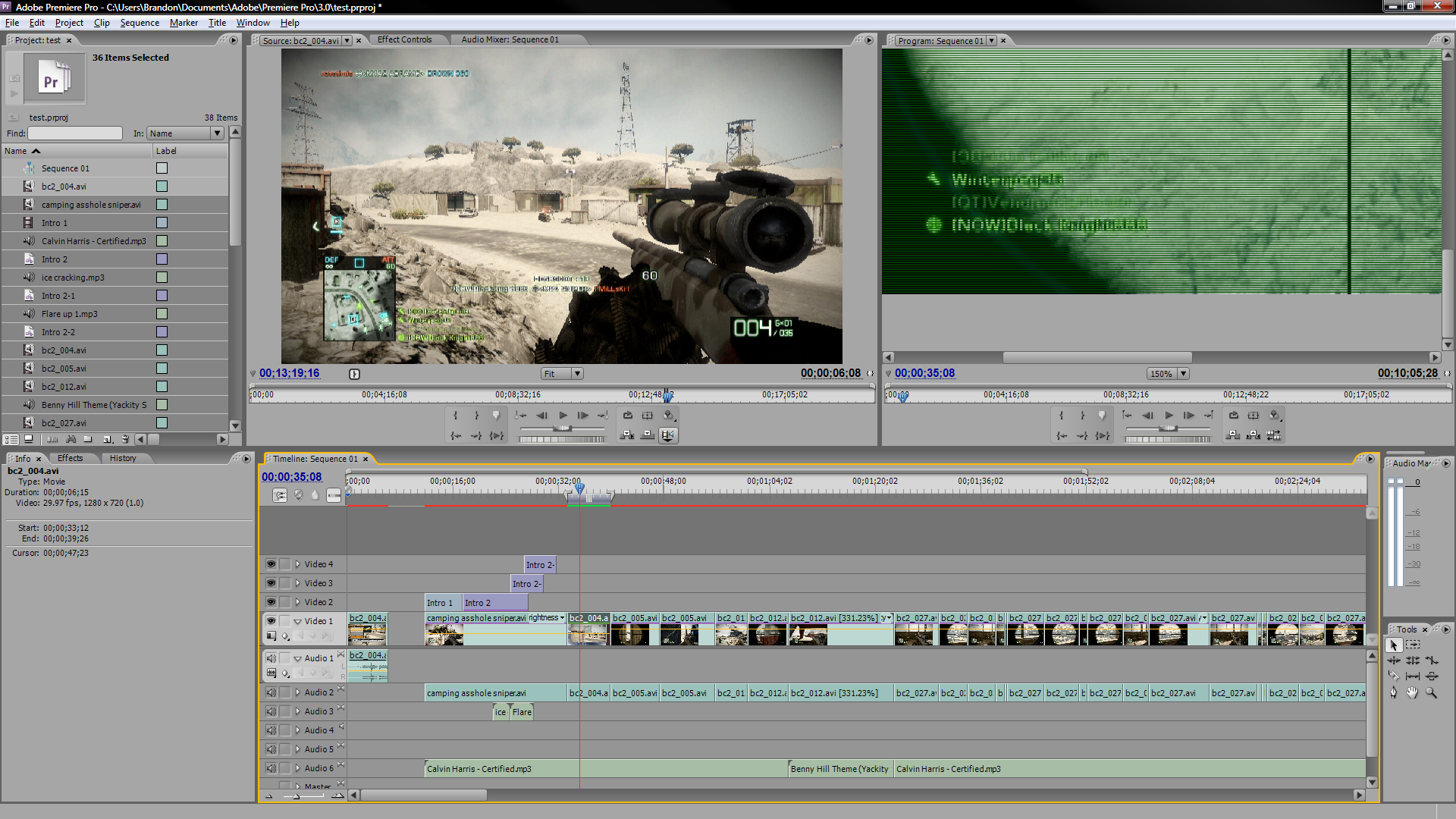

  8. Sorry. I made a new project with "desktop" and selected 1280x720, progressive, 29.97 etc. I brought in one of my 29.97 source files into the clip bin and then took it from there and put it in the timeline. In the preview window I can immediately see it doesn't suffer from my issue. Well, I still have my entire original project copied to my clip board and pasted it into this new desktop project. The preview shows my original clips still being messed up. I then had the project render one of the original clips and it produced this preview that I attached a pic of.
    It looks as if it was completely tossing a field out and just doubling/blending the one field!
