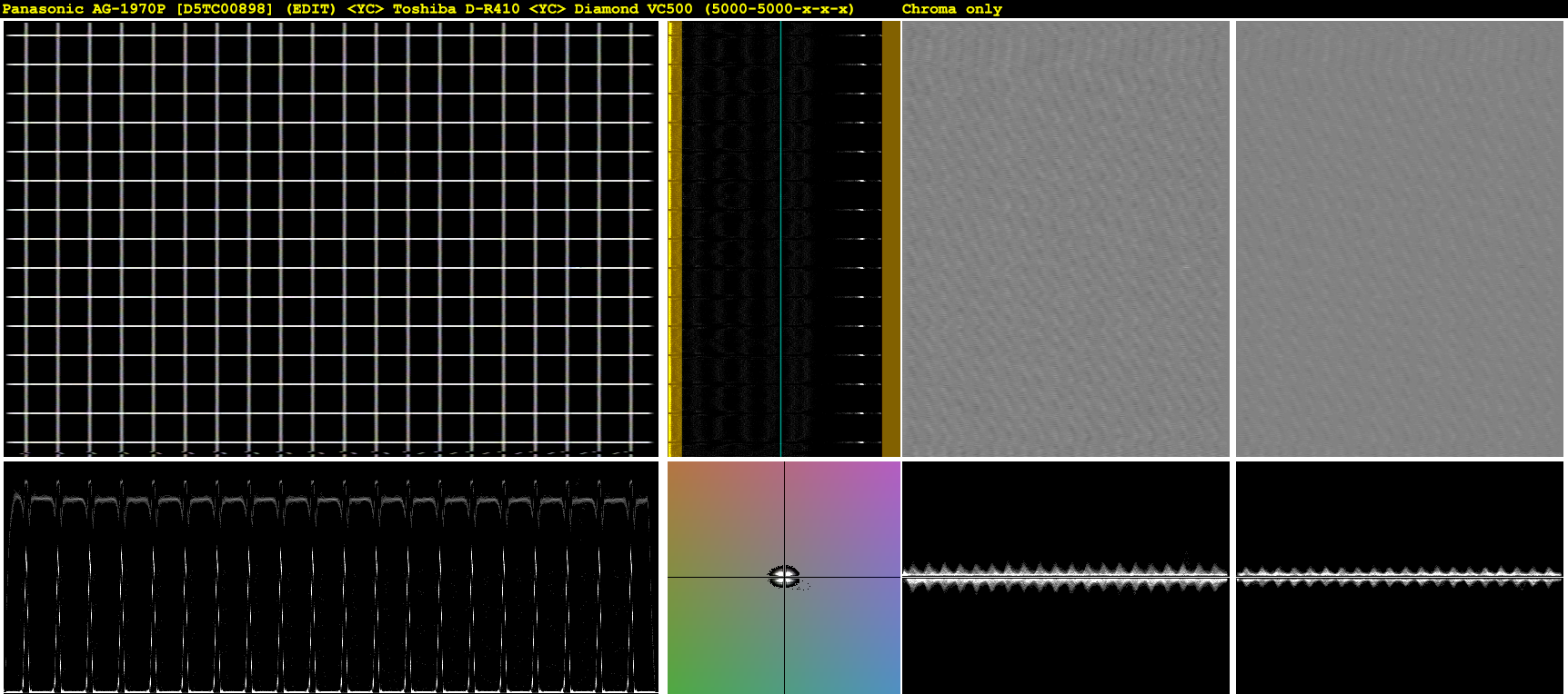

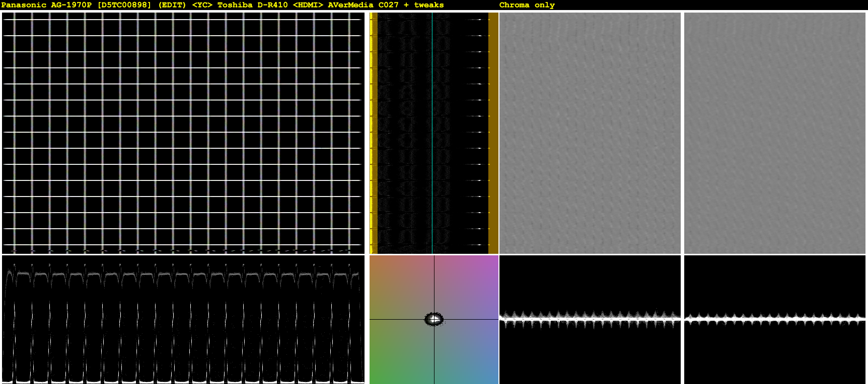

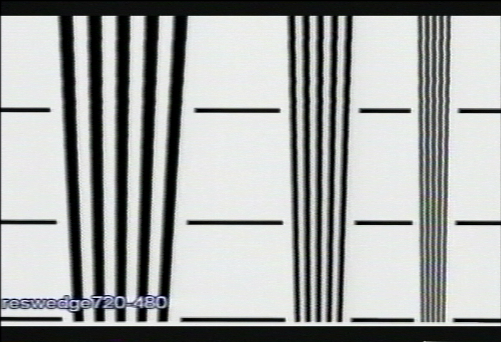

    With the tapes I've tried, the Toshiba D-R410 offers the same level of line correction as the DMR-ES15. Nice to see that's still available in a 2008 model. It seems to provide continuous sync, as when it encounters a total input drop it resorts to showing a blue screen.
    The lowest resolution it outputs via HDMI is 480p, but the original fields can be chosen from this capture to create a 480i video. For some reason it refuses to offer me the option of outputting YCbCr to my capture card, so I'm forced into an RGB -> 4:2:2 conversion.
    VC500

    D-R410 -> HDMI 480p + AssumeTFF().SeparateFields().SelectEvery(4,0,3).We ave().ColorYUV(off_y=0,gain_y=-16)

    However... similar to the LG recorder I recently posted about, it features spatial noise reduction that can't be disabled (lower strength mind you), and I experienced AGC issues. This time, the AG-1970P triggered it while the Sony SLV-585HF (CVBS input) was smooth sailing.

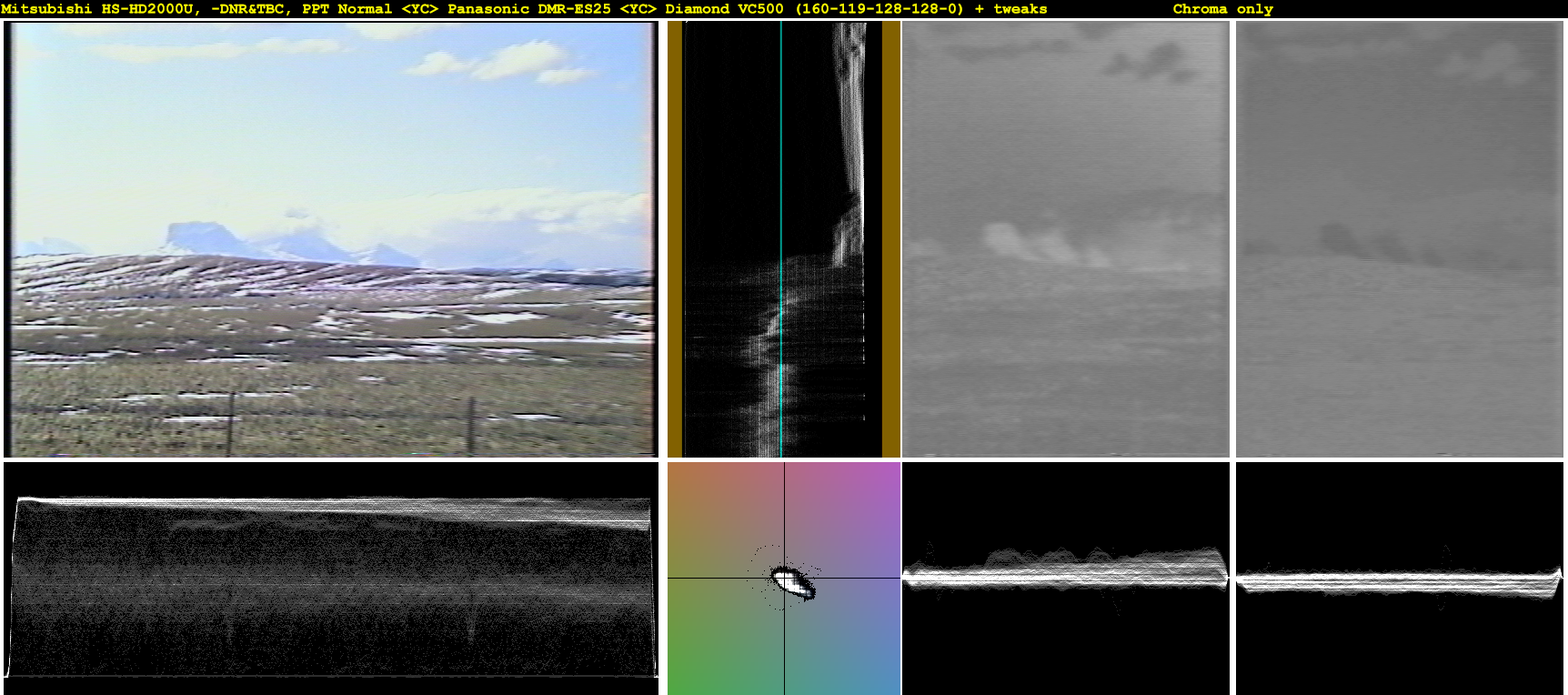

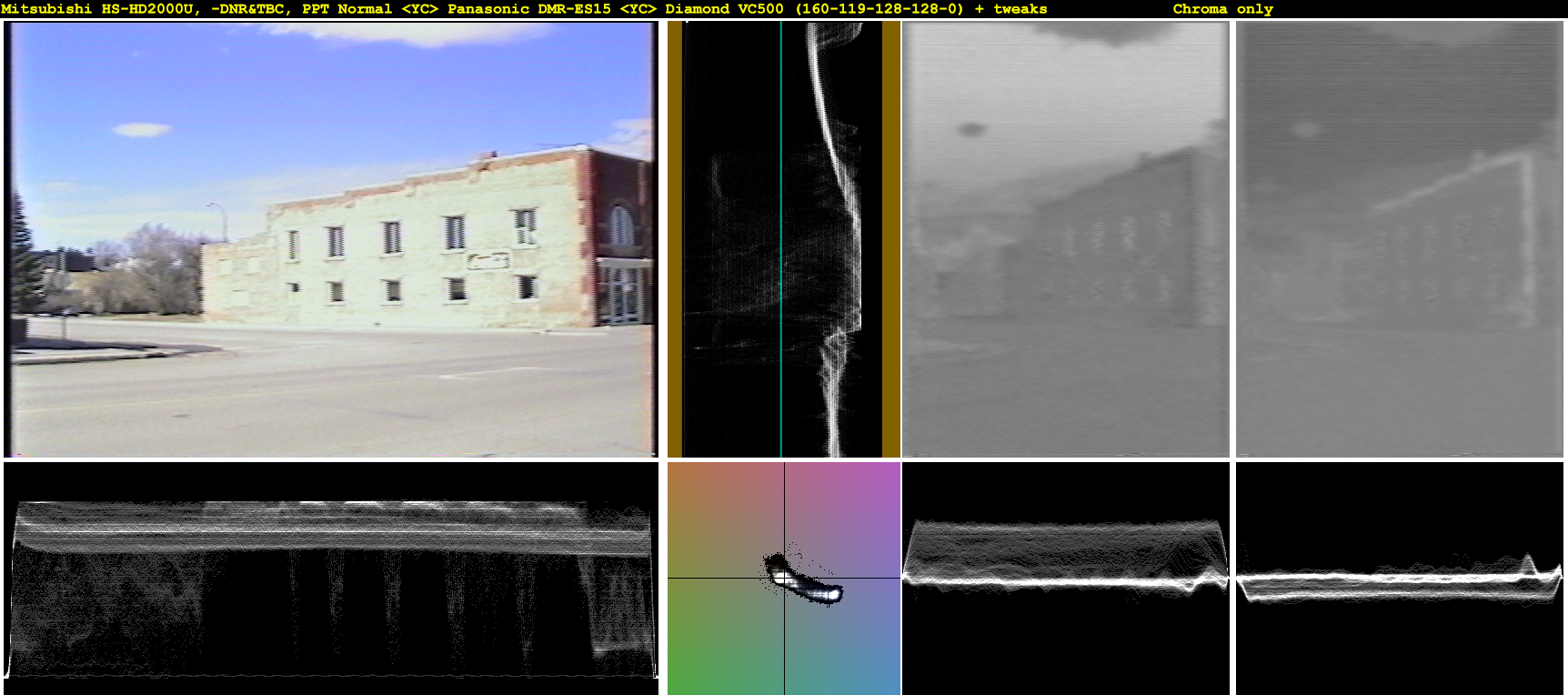

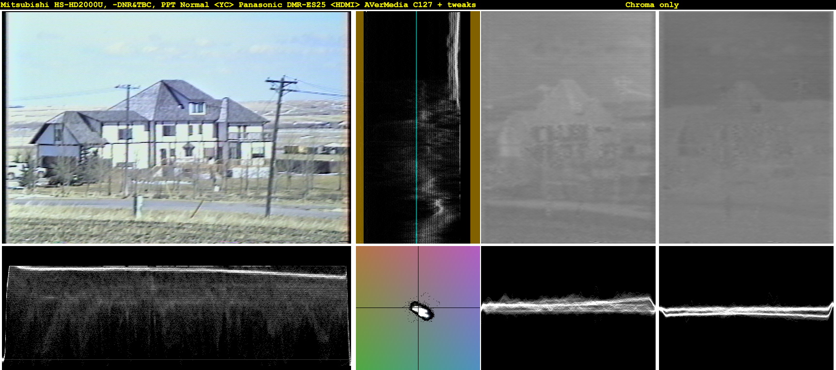

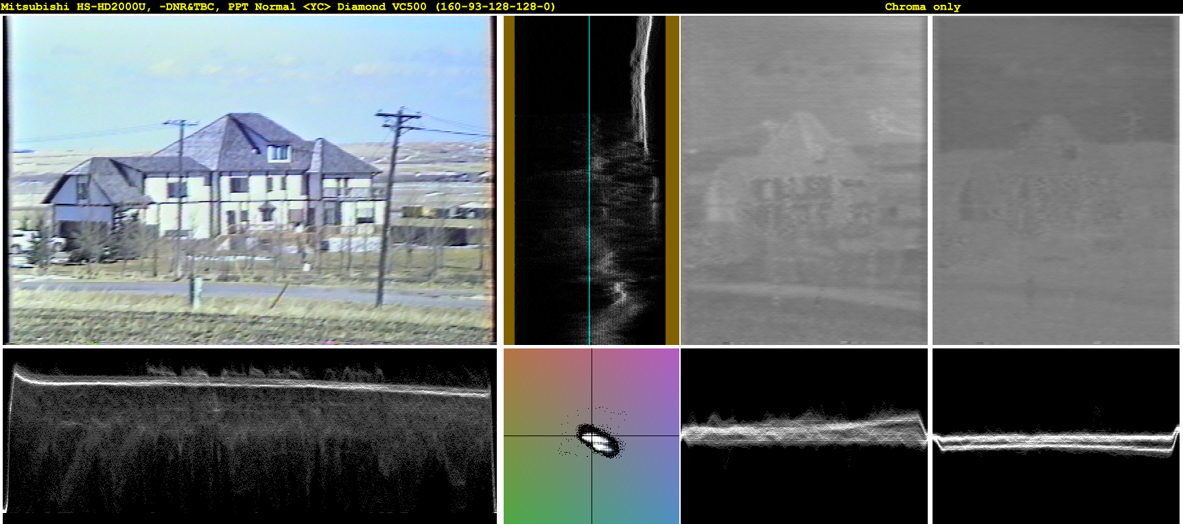

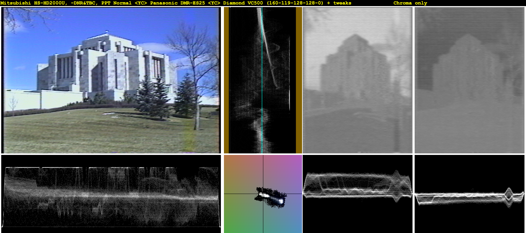

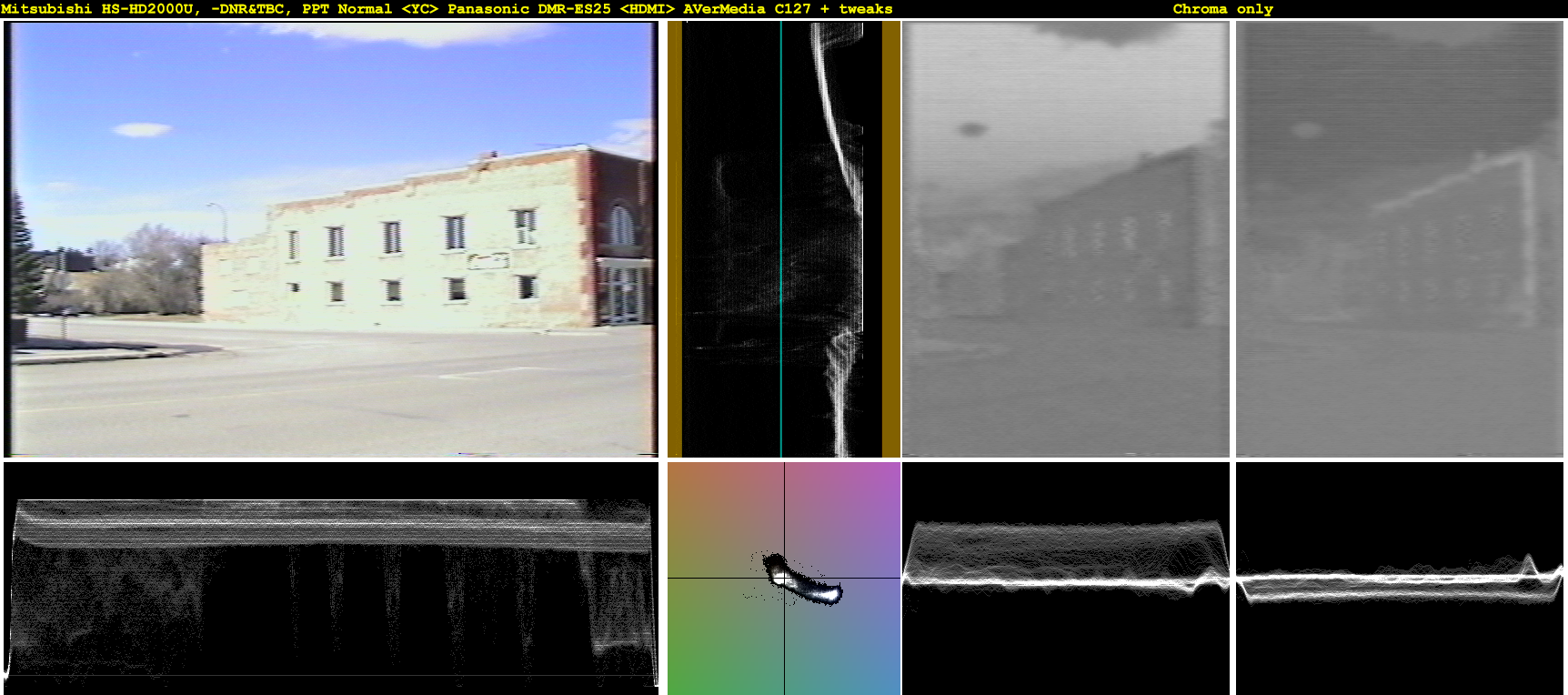

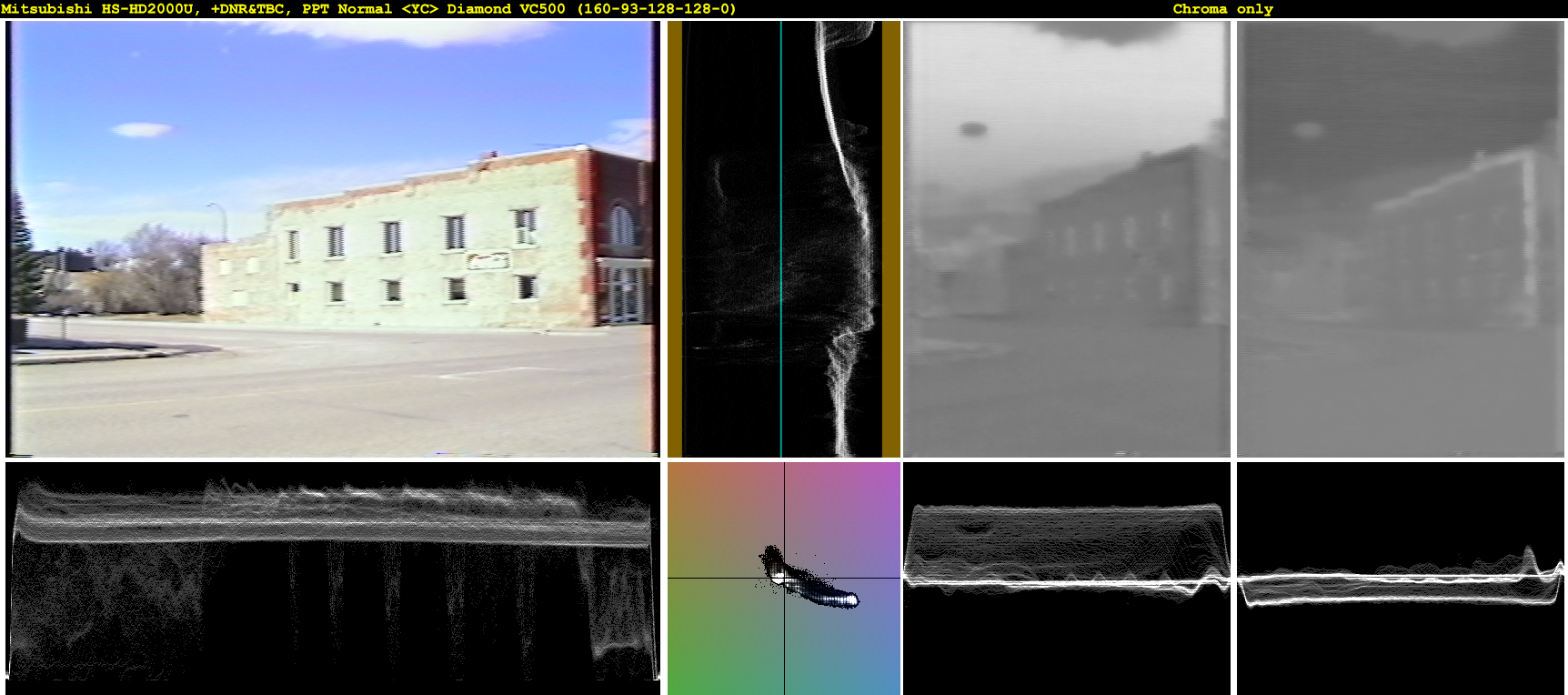

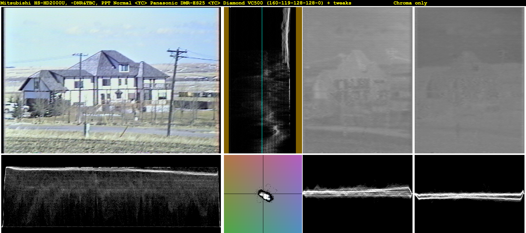

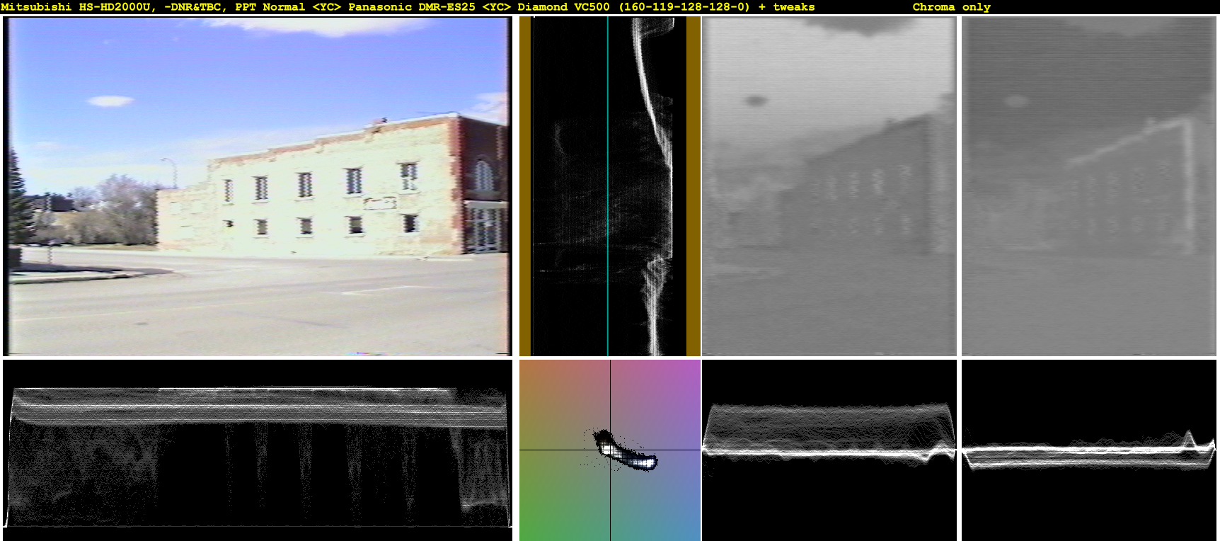

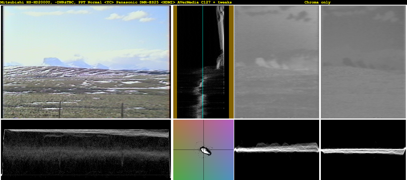

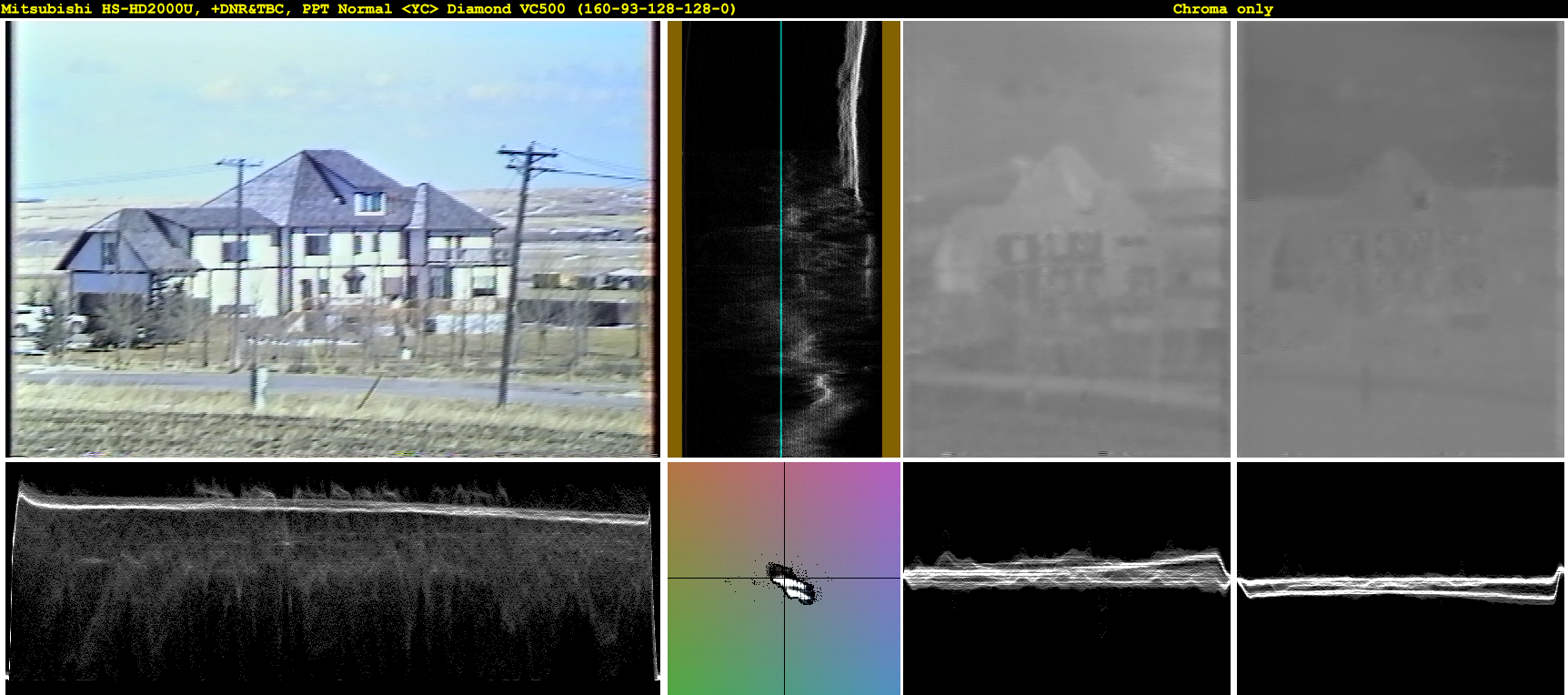

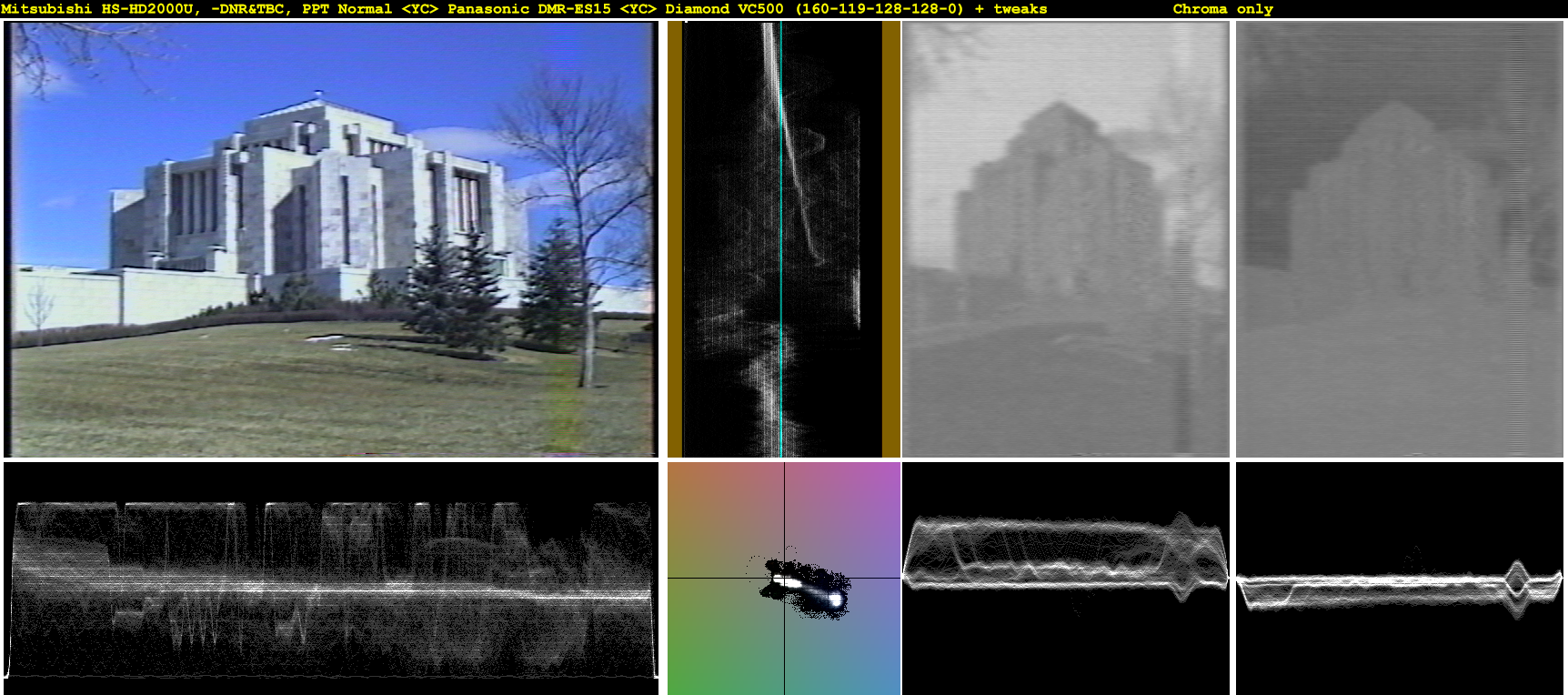

    From what I've seen, the DMR-ES25 has equivalent line TBC performance to the DMR-ES15. But when a VHS signal is particularly bright, both clip white peaks.
    The ES15 appears to offer a tiny bit more headroom than the ES25 (assuming this is repeatable and not just a one-off AGC quirk). On the other hand, the ES25 offers the small benefit of HDMI output (eliminating a D-A-D step).
    The HDMI capture has been reinterlaced from 480p. The two DMR-ES25 captures were done at the same time; all others were done while replaying the tape at different times.

    Partial Avisynth scripts used are below. There were some field oddities that I had to correct for the sake of keeping all 5 sources synchronized to each other. The Panasonic captures are all consistent with one another, but comparing the Panasonic group vs the other two captures: the -DNR&TBC direct capture is missing field 3021, the Panasonic group duplicates fields 3017 & 3018 and is missing field 3019, and the +DNR&TBC direct capture is missing field 3022. The Panasonic group also has brief vertical anomalies around the same time; these are corrected by the script but without it there is a little added jumpiness.
    All of this field weirdness is confined to the first 12 fields after one recording ended and the start of the next recording, so it isn't particularly noticeable in viewing. But in each case, VirtualDub reported no dropped (or inserted) frames in this area.
    -DNR&TBC <YC> Diamond VC500
    AssumeTFF.SeparateFields()
    Trim(0,3020)+Blackness(last,1)+Trim(3021,0) #One field missing; present in Panasonic captures, and this is a different missing field than +DNR&TBC capture... Doubly confusing!
    Weave()
    -DNR&TBC <YC> Panasonic DMR-ES15 <YC> Diamond VC500
    ColorYUV(off_y=4,gain_y=-28)
    Separated = last
    Separated
    Trim(0,3011)+Interleave(Trim(3012,0).SelectEven().Crop(0,1,-0,-0).AddBorders(0,0,0,1),Trim(3012,0).SelectOdd().Crop(0,0,-0,-1).AddBorders(0,1,0,0))
    DeleteFrame(3019,3020) #Duplicates of fields 3017/3018. Have to delete individually since they are split across two frames.
    Trim(0,3018)+Blackness(last,1) #One field missing; present in VC500 direct captures.
    Fix1 = last
    Fix1+Separated.Trim(3021,0)
    Weave()
    -DNR&TBC <YC> Panasonic DMR-ES25 <YC> Diamond VC500
    ColorYUV(off_y=4,gain_y=-23)
    [same "Panasonic Fix" block as above]
    -DNR&TBC <YC> Panasonic DMR-ES25 <HDMI> AVerMedia C127
    AssumeTFF().SeparateFields().SelectEvery(4,0,3).Weave()
    ColorYUV(off_y=8,gain_y=-48)
    +DNR&TBC <YC> Diamond VC500
    Trim(0,3021)+Blackness(last,1)+Trim(3022,0) #One field missing; present in Panasonic captures, and this is a different missing field than -DNR&TBC capture...
    Weave()
  8. Is that clipping caused by the DVD/TBC?
    Is it digitalizing the image and sending it through HDMI (DVD with HDMI port?), and also S-video (reconversion to analogue?).
    Okay noticed you wrote that above the images -_-
    But damn that Noise reduction is visible, compared to the DVD which looks pretty much the same.
  9. Formerly 'vaporeon800' Brad's Avatar
    Apr 2001
    Vancouver, Canada
    Yes; the NR settings on the DVD recorders are turned off since they do more harm than good.
    I forgot to mention, these captures were done using the "IN2" front inputs of the ES15 and ES25. Some other folks have said that their ES15 doesn't do line correction for the front connections. Dunno how to explain that one.
  10. I meant the noise reduction on Chroma with TBC+3DNR (or whatever it has).
    It looks like butter compared to the original source and DVDs.
    Luma however, really sad that it's clipping so hard, truly a deal breaker if you ask me, as you got no way to get the colors back.
    I am the DVD is amplifying the signal way higher than what it's supposed to, so it will clip when converting to Digital.
    Only solution for that as far as i know would be to De-Amplify(?) before inputing into the DVD.
